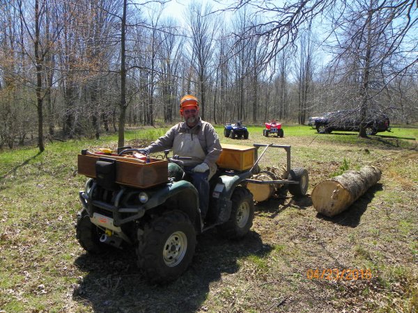

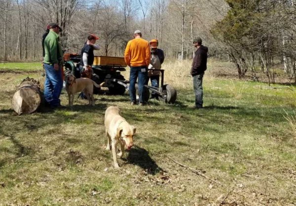

    Here is smiling Walt with his log arch. He pulled some heavy, heavy loads with that atv and log arch. Those logs in the picture were pulled 1/2 mile! He made it look easy.

    Another Yamaha grizzly making it look easy!
  5. Eric VW
    24,403
    140,443
    You could here Ol' walt a 1/2 mile away on that bad boy.....Torque monster!:yes:

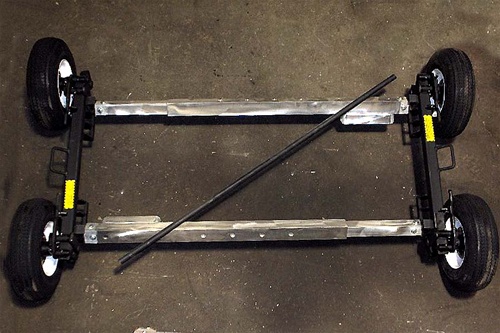

    I've seen high speed wheel dollies used in conjunction with arches like that at the other end of the log to keep it from draging. They are sometimes used in vehicle towing. The one I saw was a home brew version. This one is a commercially available unit:

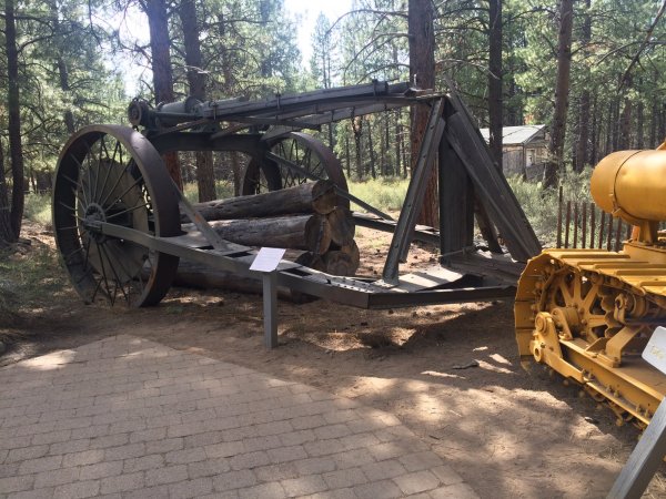

    Saw this today. Old school logging.
    This one had a hydraulic winch over the arch to pick up the logs.
    The horse drawn ones were designed so that when the horses pull the boom moved forward and used some leverage to lift the arch and the front of the logs. If they were going downhill the boom moved back and dropped the logs down into the dirt, thus providing brakes.

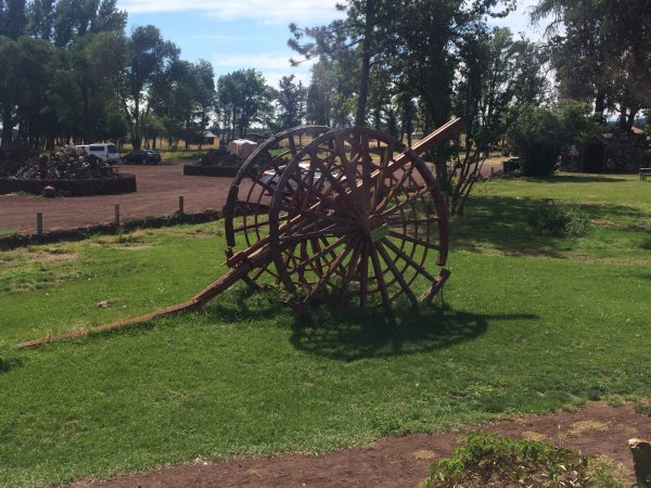

    Here's a horse drawn one. Oregon Cascades style. Certainly has seen better days. It would have had metal hoop wheels.
    You can see how the boom is slotted. I think it has some sort of cramming action that cranked the rod above the axel, thus raising the log when pulled forward and lowering if they were going down hill and the arch started to move forward.
