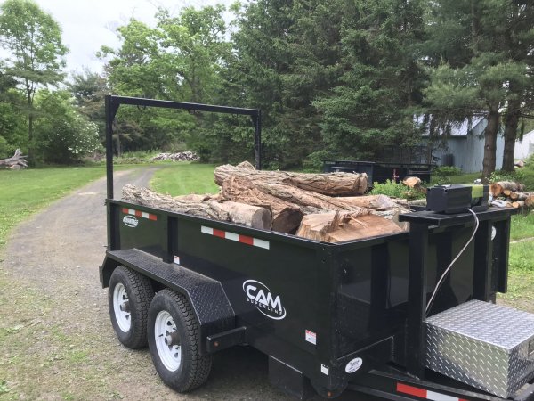

    Grabbed up one more today. Maybe my last. There’s still some scrappy BL left and some nice big logs. The big logs are hidden behind a HUGE maple trunk and some pine. Ugly trunk that is. To get the BL out I’d have to move that big ugly maple and pine into their driveway.

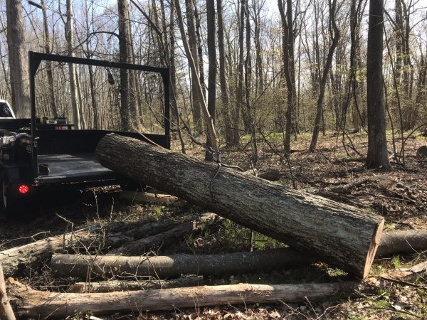

    How are you stacking those logs in the trailer like that?
  3. jo191145
    jo191145
    7,227
    50,370
    Ct
    Winch and a tong.
    Here’s a pic in the middle of the process. First step lift First end of log onto trailer. Move tong down log and hoist second end up which will pull it onto trailer. Rinse and repeat. In the pic I’m going too middle of the log. Sometimes I’ll take smaller steps for safety. Much depends on the log, surroundings and my mood :)
    like this photo with all the extra tripping hazards and empty trailer it pays to take a little time. If I were to pull from the rear of the log it’s easy for the log to spin sideways. I’m too gimpy to get out of the way in time LOL

    totally awesome! How much you think you ended up with?
  5. jo191145
    jo191145
    7,227
    50,370
    Ct
    The reason I don’t go to the casinos is because I’m such a good guesser LOL
    Would hope I’m at 2 - 2.5 cord.
