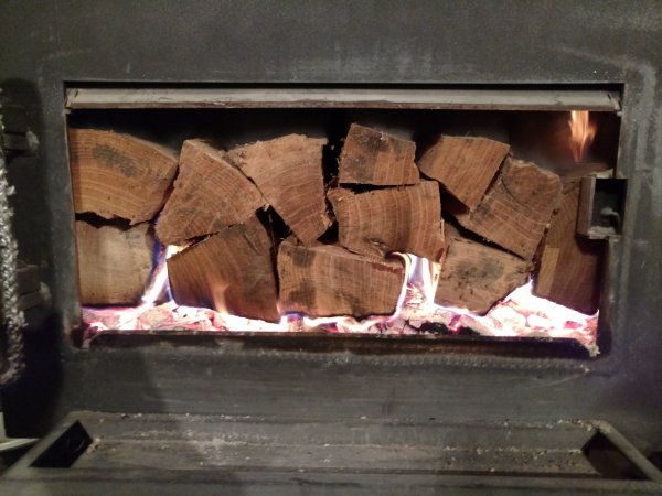

    We have a Drolet Blackcomb. At night, we try to pull all the coals to the front, which will leave a deep trough at the back. I then put a large split or 4-5" round in the trough, then load shorts/chunks on top and fill the stove. We have gotten a good 6-8 hrs burn doing this....
    This was a couple yrs ago, loaded the stove at 10:30PM...red oak splits 10-11" long IMG_20170315_223545244.jpg

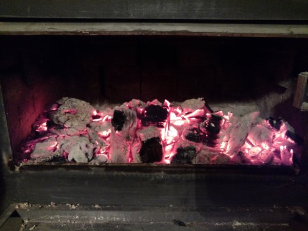

    Worked 8 hr shift, checked stove at 7:30AM when I got home. It was 21° or so outside, house was mid 70's inside IMG_20170316_073952771.jpg

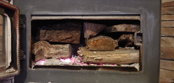

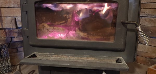

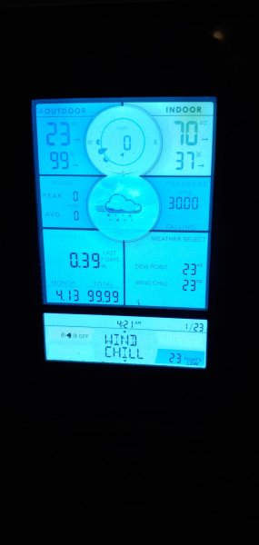

    Shut air off, let it cruise. This morning about 4:20... 0123220421.jpg

    T.Jeff Veal, a fully stuffed stove is a thing of beauty. My wife would raise her eyebrows and give me a look over her glasses with that comment. :loco: :crazy: Those are great burn times. I like your hybrid load from last night. :yes:

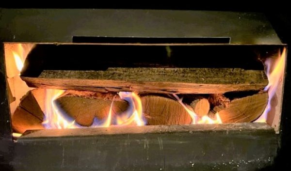

    brenndatomu, here's my N/S base and E/W top hybrid, as you suggested. It could be crammed fuller, but it makes it more difficult to cram it full when there's a hot base of coals to start with. With all my wood cut for E/W, I really like this N/S base with an E/W top. I still need smaller stuff for cramming, especially on the ends. I'll see how it's going at 3:00 am, when I get up for my nightly break, and reload.

    Well, at 3:45 am, it still had some chunks to it, with a lot of coaling. Surprised it was down to 73 degrees in this room. It's 12 degrees outside. The last few nights it's been about 80 in here, with E/W loads.

    The wood can make a difference. Sometimes a N/S load won't burn as hot, but will burn longer than a E/W load. On our hybrid loads, I pull the coals foward, put a big round E/W in the back, then load stove with chunks N/S.
