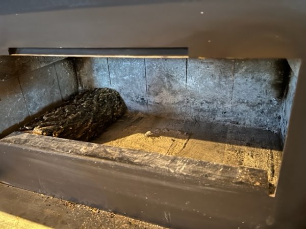

    The experiment begins. Loading N/S is my first test, and splits can't be longer than 11”. Instead of using a chop saw, I laid 2 pallets on the ground and placed several 20” splits between them and used my chain saw to cut to length. I'm using red oak and red elm, well seasoned of course. I cleaned the stove because it needed it, so this is a cold start.
    For the first layer, I used a couple of the 9” pieces in the middle to leave room for the kindling, and allow the bottom air vent room to breath. I got the fire box mostly crammed full.
    I lit the stove at 2:45 pm, within 10 minutes I shut the air down to about 20%, I eventually closed the air wash as much as I can, this is where it's been cruising. There's a fine line between choking off the fire and leaving just enough to keep it going to start.
    About 20 minutes later, there is a fair amount of smoke coming out the chimney. At about 350 degrees on the stove top thermometer, the secondary burn is starting.
    At 45 minutes I choked the air off as much as I can. Secondary burn is going well, mostly on middle tube. The stove top temp topped out at 625 degrees, flue temp at 725.
    About 90 minutes later, the temps dropped to 575 stove top, and 650 flue. The stove has settled into cruising. The temps are slowly dropping from here. Just from this first trial run, I would feel comfortable going to sleep with this.
    At this point, I'll see how long it burns. Almost all my wood is red oak and red elm for this year, so I can't really experiment with anything different there. I'll probably have another test run with N/S, then a couple E/W runs.
    Edit; Already, I just realized in real time, when loading up for bed time, there will probably be a good amount of coals. That will probably get it hotter faster, especially from the bottom of the stack. I guess that will need to be part of my next test.
