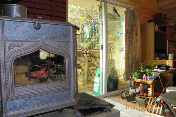

    Fireview loads from the side.
    This makes it really handy for our stove as you can see the wood rack (along with some of wife's junk) in this picture.
