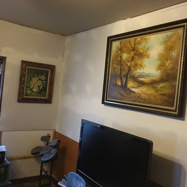

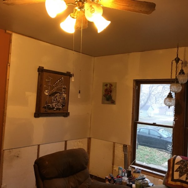

    Waiting for the last of the touchup mud to dry, texturing tomorrow. Got our garfunkles hung so I could patch any holes from mishangs-- have two little screw holes to patch.

  9. wildwest
    30,694
    144,847
    Great progress!! PS, we are still laying flooring, moving furniture and stuff from one part of the room to the other, pia for us....
