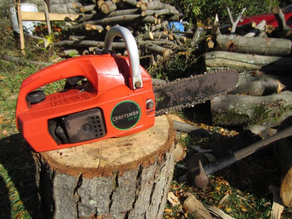

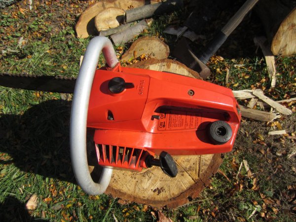

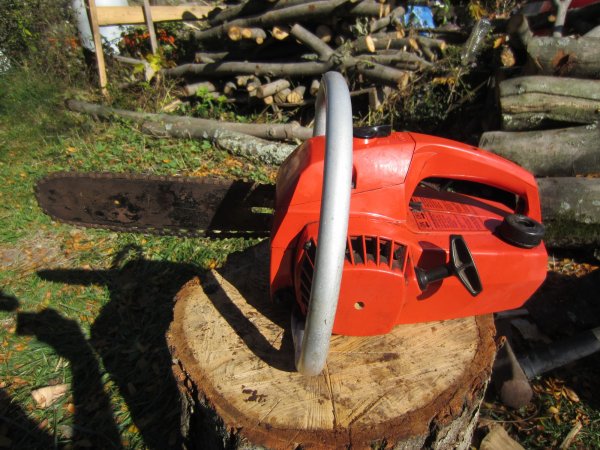

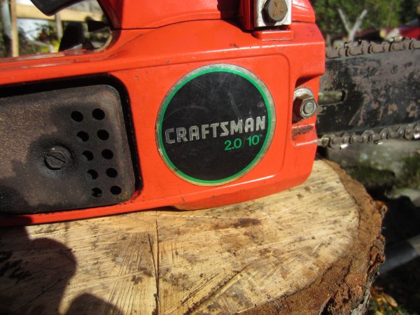

    IMG_1800.JPG IMG_1801.JPG IMG_1802.JPG IMG_1803.JPG IMG_1807.JPG Yesterday I gave some cherry splits to my elderly neighbors as a gift. Today he returned the favor and gave me this little Craftsman 2.0 with a 10" bar, and a few other goodies! He cannot see well enough to use it anymore, and thought that I would give it a good home. I kindly thanked him, and told him to look out for more firewood to come his way!! All I need to do is fix a busted gas line, but it does work. I cleaned it up a little, and poured a few drop of gas mix in the throttle body and it fired up. Sounds promising, just needs that line fixed and a new bar soon because I noticed the tip is quite worn. It says on it to use 16:1 gas:eek:il ratio, but I researched and the net says that is for old school type oils, and the new synthetic oils should not be used at that ratio. Check out the pics and tell me what you think! I am up to two saws in my arsenal now. CAD here I come!!

    thanks guys! I believe this saw is older than me. There is a 77 stamped on the carb, and did conclude through my research that it was made for Craftsman by Poulan. Now I am checking out info for the Poulan XXV, tanks for the info!!

    I just picked up the fuel line, fuel filter, and carb kit from my local shop. Thank you again for pointing out that this saw is identical to the Poulan micro XXV, there are tons of vids and info on fixing them up. Gonna get this puppy running today!

    IT'S ALIVE!!!!!!!! Just did the fuel line. It roars! Gotta figure out why it is not oiling the chain, already cleaned the channel on the bar but that is not it. Still have to do the carb kit, but I am happy with the progress. I filed off the sharp worn section on the nose of the bar. What a cool little saw.
