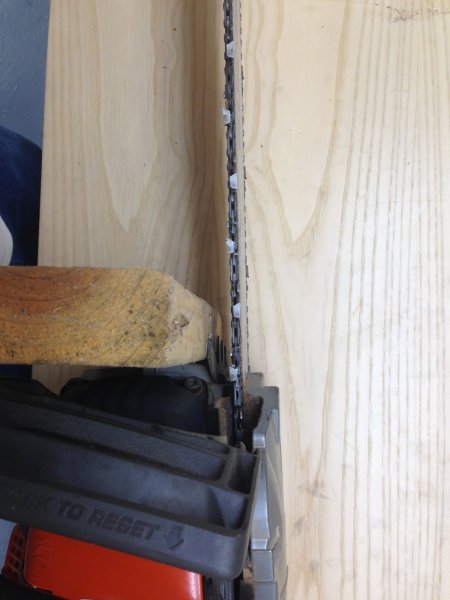

    Gonna have to go to 16" on the width. Good call. Andbody ever use the dawg as a guide like this?

    Interesting.. I'd rather use the outer dawg though. Your left hand is going to get really hot because the exhaust is pointing right at that board. Maybe your saw too.
    I sometimes have to use the dawgs to pin down smaller branches under 4" or so. They like to roll around or jump right out of the stand when you touch the chain to them because they're so light.

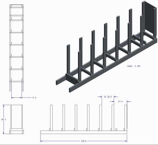

    okay, after some refinement...
    can accommodate 56cuft if all the pieces are 12' long.

    That's way to get er done, your ready to rock now buddy:thumbs::saw::stacke:
  12. HDRock
    17,268
    60,522
    It's going to take a little while to load that bugger up, let us know how it goes loading those 12 Footers in there

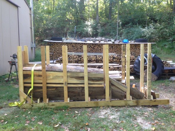

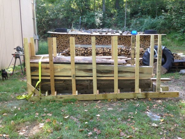

    Thanks for talking me into this sawbuck thing guys. I feel this processing is faster than hauling it out of the wood myself. Going for a trailer load tomorrow! Will see how it goes to fill that thing to the top. I went 5' and i think i might cut them down by 6".
  18. cnice_37
    cnice_37
    3,212
    14,244
    I stack it to the top, no ratchet straps needed if you put a couple heavies on top.
    Looks good!
  19. HDRock
    17,268
    60,522
    That will do the trick :thumbs: :saw::stacke:
