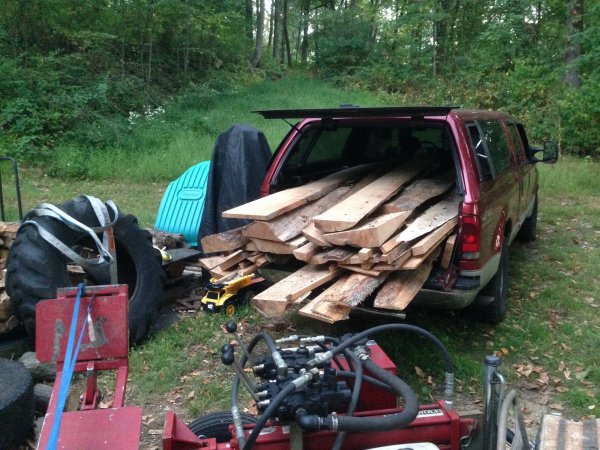

    This is what i am workng with. Will take some more time and pile higher next load.
    I played with the one hand electric saw. Need more faster method.
    Working on acquiring a roller table.

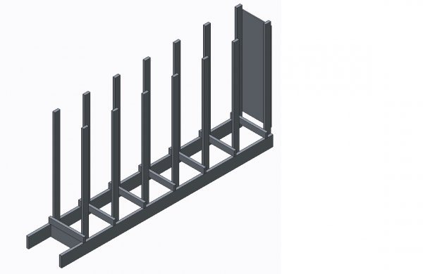

    something like this?
    currently accepting criticism. its 12' long, 6' high, 18" inside width between uprights (20" bar). i want to run the clutch cover up against the uprights to use them as a guide. pieces should come out 20.5" long minus cut width. i can fit 21" in boiler. is 6' too high? i dont necessarily need to pile them in there that high but i also dont want to lift higher than needed if i am loading this thing from the side.

    I load from the top mostly, so 6' is perfect to maximize cut distance and what I can comfortably lift. They do get a bit wobbly being so tall but only supported at the bottom.
    It might be rather long at 12' but easier to shorten after if that is case.
    You need to re-consider the 18" with a 20" bar.... dawgs will eat into your cut length so are you removing? I run the 25" bar on my setup exclusively.
    Eric VW, Star Gazer and HDRock like this.

    that wobble is my concern. i dont really wanna tie them together across the top because you lose the top load ability. running another 12' piece along the top is an option if needed.
    i got 12' boards in the barn and most of the locust i will be seeing is 12'. some 16' and 20' too that will need to get cut in half first.
    the dawgs should be out of the way as my idea is to run the front edge of the clutch cover on the outside of the upright. no dawg on 562 clutch cover. i will confirm measurements tonight on the saw. theres actually 19.5" from the inside of one upright to the outside of the other where the front of the clutch cover will guide on. i think i need a bigger saw!

    Did somebody say sawbuck? :D My biggest critique would be the amount of lumber needed to build that. My sawbucks can be built from five 8' 2x4s and can easily hold several 8' pieces for gang cutting:
    The stand doesn't need to be as long as the slabs/logs you're cutting. If you don't want the overhanging stuff to hit the ground, you could use the HDRock wagon/recycling bin method for catching the drops.
    As far as slab wood not being as good as "normal" wood, I haven't had an issue. It gets stacked in with the rest of my "normal" splits; which are sorted by species.
    Another thing about the H-buck design - I think it encourages you to pile too much in there, and then it looks like it might be more difficult to get back out. If I just want everything in a pile beneath my sawbuck, all I need to do is push the middle stack off the stand, and the rest usually falls away too.

    hmm...it is a lot of lumber. if i backed it down to 4' high that would eliminate almost 50% of the 2x4s i need plus lessen the wobble factor and make be work smaller batches. i plan to use mill scraps to build the thing anyways. except for the 2x8s at the bottom. i got a pair of pressure treated that have been waiting for a project. i dont intend to be moving it around much.

    I sure wouldn't build it 6' high cuz that would be to high for my height, I'd have to get a ladder :rofl: :lol:
