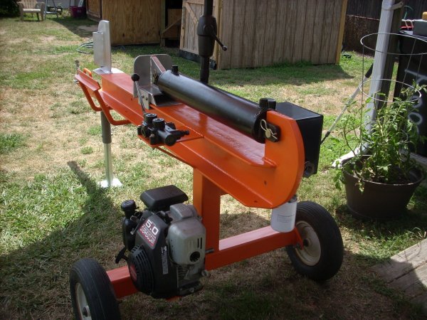

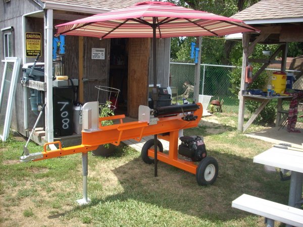

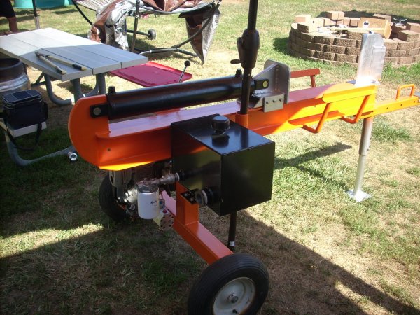

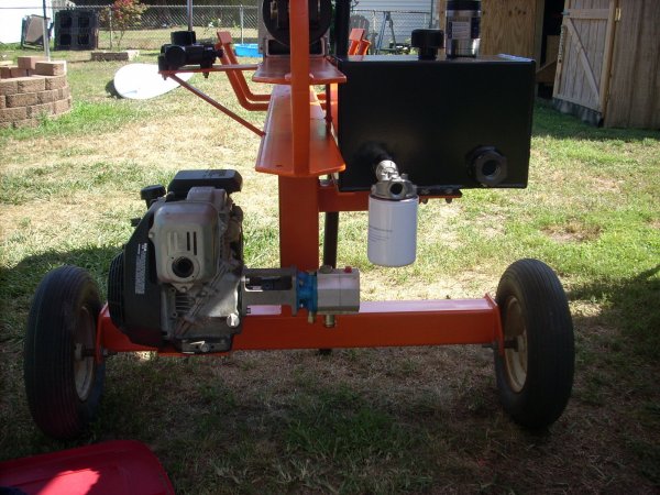

    Today I got the internal filter on/in, return filter on, detent valve on and pump assembly all together. Almost all done :popcorn: but the Christening :banana::drunk::cool:. I'm taking it to have the hydraulic lines done, I have a friend in the business who will make them real "spiffy"! :handshake: :) should be done by next Friday. It was 92* in the shade under the umbrella, I'm getting a Beer and a cold shower!!! :cheers:

  4. cnice_37
    cnice_37
    3,212
    14,244
    So WeldrDave is this the keeper splitter or the used one you scored? This one is looking good, my only nit pick is the log cradles, why not a wider wing (for lack of a better term)? And for a fixed wedge are you planning an outfeed table?
  5. WeldrDave
    10,207
    56,307
    Keeping them both! Log cradles are size needed for my log I'll cut, very rarely do I go much bigger that 24" and the out feed tables will be two wheel barrows at the end of the splitter. "To me" less is more on it, usually I'm moving it around by myself in the yard, It will never go very far. :)

  6. triptester
    triptester
    Oct 23, 2015
    67
    308
    S.E.Wisc.
    WeldrDave did you consider a valve between the tank and filter or the tank and pump for filter change or pump repair.

  7. WeldrDave
    10,207
    56,307
    Actually Yes! The normal filter change is about 250 hours and I'm not so worried about draining the fluid out if needed. I thought about bracketing a valve and piping the filter in another direction but I wanted to keep it as compact in the back as possible. As strange as it may sound, I'm not to concerned with it. :) But very good point! Also, "Welcome to the forum"!!! Nice to have you here!

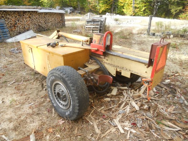

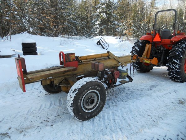

    Made it back in the early 80's out of junk. The toolbox is handy as I used to have to travel to the wood and there was never room left in the p/u for the saws & cans. It will stand up vertical but I hate bending over and the normal (horiz) operating height is about 3'. The beam is a (undersized) house beam, the engine is an old Kohler from a Gravely walk behind tractor. The knee operated valve allows me to cut off the fingers on the left hand while simultaneously squishing the fingers on the right hand. :eek: 9540 004.jpg DSCN3791.JPG
  10. Eric VW
    24,572
    141,783
    :eek:
    Sweet hubcaps.....Ford?

  17. WeldrDave
    10,207
    56,307
    That's one "BEEFY" splitter fuelrod!!:cool:
