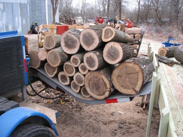

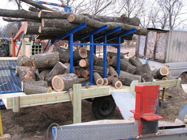

    However, my hydraulic splitter with the 4 way, log lift, & a 8.8 sec cycle time meets my needs well. Of course having the log bucking trailer & tractor with loader doesn't hurt.
    - Set logs on bucking stand.
    - Cut the logs while being able to stand up straight.
    - Cut rounds fall towards the splitter side.
    - Load the log lift. Larger rounds are just rolled onto the lift. Again no picking rounds off the ground & the wood stays clean. (Well most of the rounds stay on the trailer, however occasionally one will find it's way out. Ask Sunfish.)
    - Split away.
    - Splits stay off the ground thanks to out feed tables.
    - Toss into trailer, truck, pallets/crates, or use elevator.

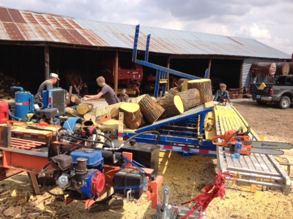

    I love being able to process the logs with minimal bending over & keeping the wood clean!
    This setup has been used at several charity cuts. We have 1-2 saw operators, 3-4 splitters, the loader operator, & of course, the food! When logs & loader are available, it works great!
    It has been updated since these photos. There are fences on both ends & storage boxes for the saw operators to stand on.

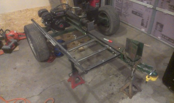

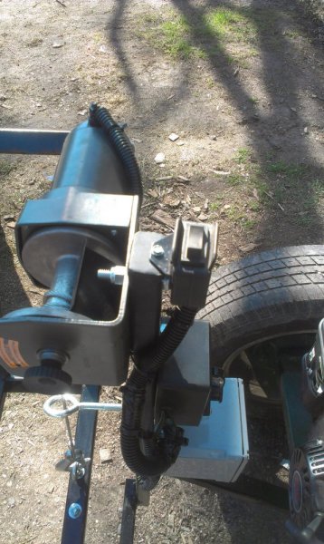

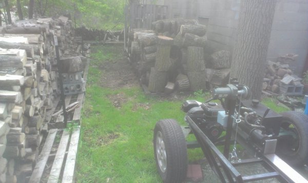

    My homemade refurbished heavily modified splitter lol. It has a HF Predator motor, 2 stage 16 gpm pump, 28" ram, HF Badlands winch with 29' of cord to attach to the truck while running so I can power the lift and a lot more to come in my ongoing build....

    That might be the ticket there I was looking for a non hydraulic way to power a log lift.

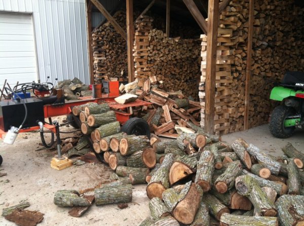

    Here's my splitter by the wood shed, and under that is my splitter and Oliver's splitter trying to keep up at the inaugural run of his log bucking trailer..
    Look at all that beautiful yeller wood!!!

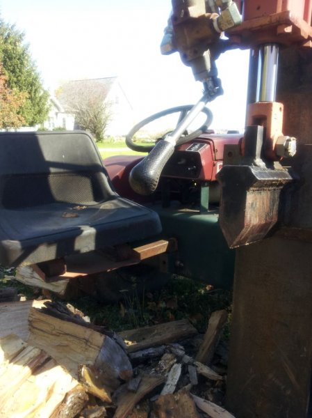

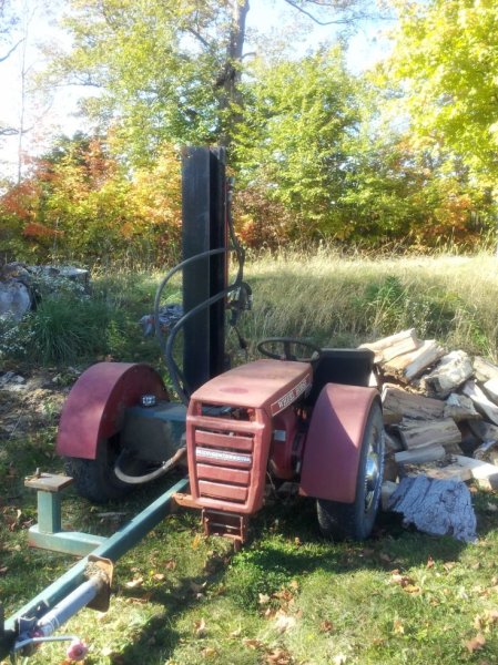

    Never try to design a Wood Splitter while setting on a lawnmower and drinking beer!:rofl: :lol:

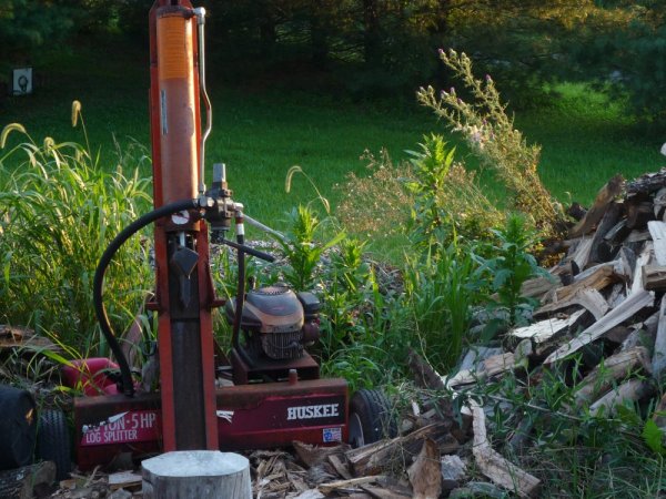

    20 ton Huskee with a 5hp Tecumseh.

    That's an old fellow right there Unclej, what vintage is it ?

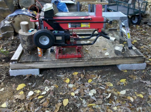

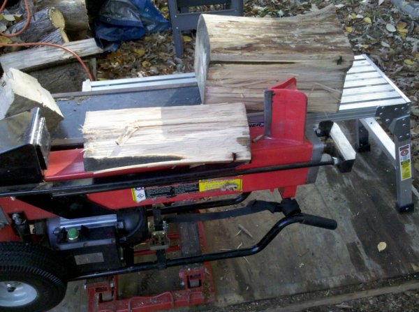

    Harbor Freight 7 ton 2 speed
    Sometimes I have to reposition the wood to get it split but for a 7 ton it does a heck of a job

    2003. I traded a couple hours of tree work for it. It was only used 1 season and the fellow decided burning wood was too much work.
