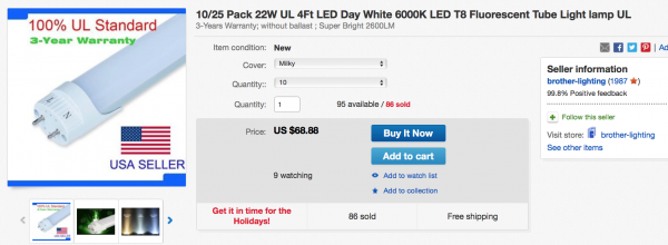

    Someone else here posted about these 4ft replacement LED "bulbs"
    I saved all my old burnt out fluorescent fixtures.
    Stripped out the ballasts and rewired them
    A hot and ground on one end of the LED bulb
    THEY WORK GREAT
    Started with a 10 pack and needed to order another 10 pack to finish up.
    Did fixtures at my house and my 90 yr old Moms.
    Great for sheds and garage in cold temps
