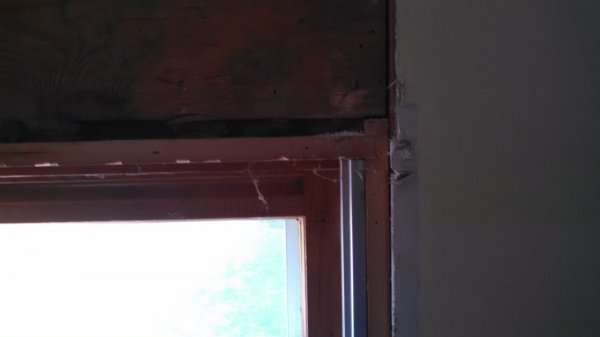

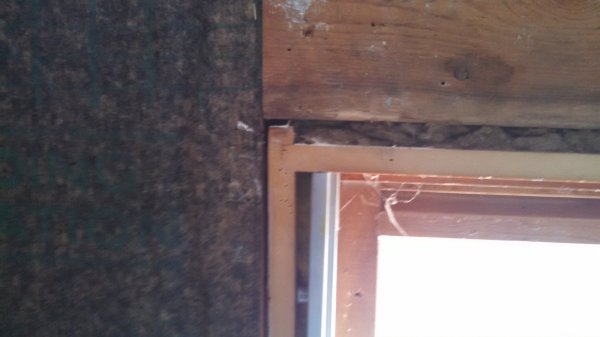

    I should be able to use a small drill or an awl to poke around for the bottom rafter cord.
    Yep, I'm not touching anything until I know the exact door we're getting.
    Nice surprise today on the laundry room header height........2X8 @ 82", so that one should be good for a regular exterior door.
    See if you can spot the problem though.............
    Stinny, yooperdave and Eric VW like this.
  2. fishingpol
    fishingpol
    6,502
    39,646
    Merrimack Valley, Ma.
    Someone forgot to dust the cobwebs or no jack studs?
    Eric VW likes this.
  3. ironpony
    ironpony
    3,745
    20,786
    Mid Ohio
    No jack studs, that will cost you 3"s. Actually you can use 3/4" plywood for jacks in place of 2x4. Dang giving away all the framing secrets.
    how do you layout hip rafters for an octagon? Google to your hearts content, the answer is not on the internet.
    Eric VW likes this.
  4. papadave
    Yep, but it's not an issue as I have plenty of room to the left of the window. There are jacks under the window, however.:thumbs:
    Didn't even notice the webs........:rofl: :lol: Those are a problem too.:whistle:
    Stinny and Eric VW like this.

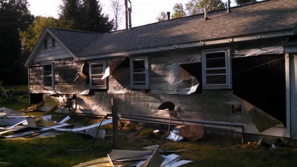

  10. papadave
    Switched gears a little today. Started tearing off the aluminum siding on the back of the house. Almost got the back done, except the gable and starter course (gas pipe in the way). The wall is a "fiber board". I've seen this stuff before, but not as structure.
    Guy finally called and said he'd be here either late this afternoon or Monday to estimate the work we need/want done. Pretty stoked about that. It's been 2 weeks since we first talked to him.
    Anybody know the going rate for scrap aluminum?
    basod, Stinny, Thor and 4 others like this.

  17. ironpony
    ironpony
    3,745
    20,786
    Mid Ohio
    run a PT band around the bottom of the house where the first row of siding is now.
    1) it will keep the siding up out of the dirt
    2) it will keep new siding from being broken / hit by weedwacker and other landscaping tools
    3) you will be able to mount the gas line securely
    4) and being you are adding a slider I assuming you can secure the new deck to it.
    I am assuming you are going vinyl
    Eric VW and Canadian border VT like this.
