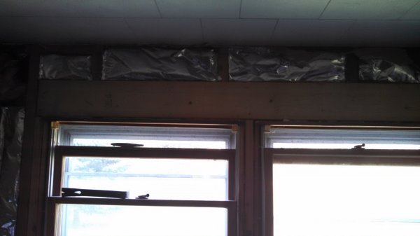

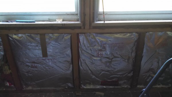

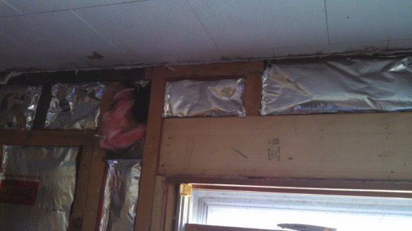

  17. papadave
    Oh man, the rafters are a WHOLE NOTHER issue. A couple are 24" OC, but some are more. I'll have to figure out where they are . Here's another couple pics
    of the wall after I finished pulling most of the drywall. Should I put in a drywall nailer at the top plate between studs?
    Pretty sure we'll stick with the 6' slider.
    Good idea on the header chase.
    What's the absolute minimum header height for a "standard" patio door? If 82", the largest header I can get in there will be 8.5" So, 2X10 ripped down, or just go with a 2X8 and be happy?
    Ceiling height is 92".

  19. papadave
    Top left pic......the two stud bays are approx. 2' OC, while the rest of the waoll is sotra' 16" OC.

  20. ironpony
    ironpony
    3,745
    20,782
    Mid Ohio
    I have seen "standard" patio doors range from 79"s to 82"s frame size, plus 1/2" for rough opening. I would cut the header to fit to avoid tiny cripples above the header.
    top plate should be doubled, if on concrete bottom plate has to be pressure treated. if you cannot find the roof rafters it is not critical.
