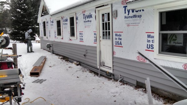

    So, they're getting much done, despite the cold. Doubt they'll be back after today until the warmer days we have coming next week.
    Just some of the back (south) wall to do, and a small section of a gable where the bedroom roof is shorter than the main house.
    West wall..........The Forsythia is blocking the view a bit

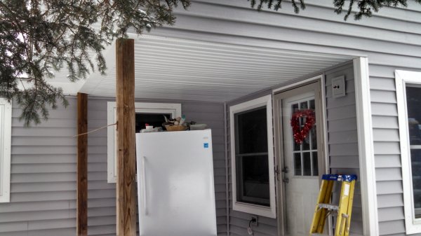

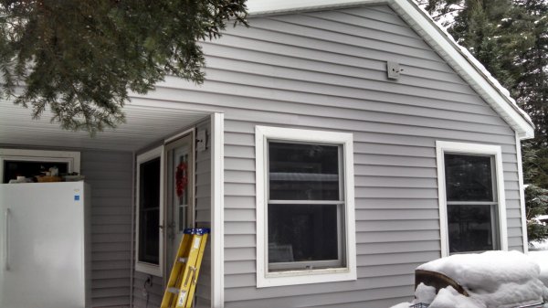

    North gable wall of stove room, and front porch.

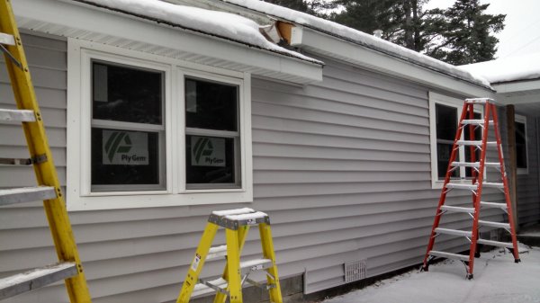

    North wall of main house, and you can see the lower roofline of the bedroom.

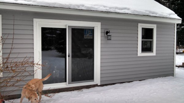

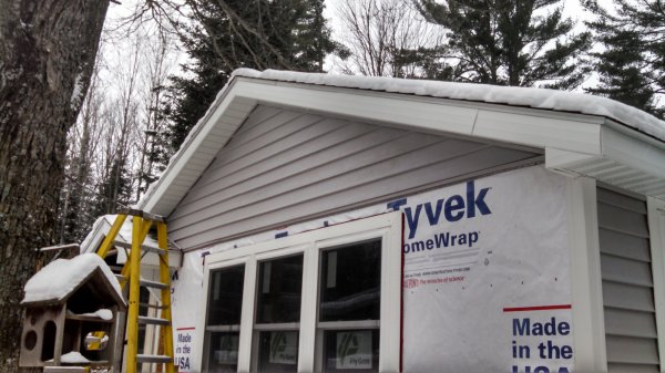

    East end (bedroom) gable, and back (south) wall.

    looks great, So how did they do the gable before the wall, curious might be a better way?
    love ranches, no scaffolding,
    savemoney and papadave like this.
  19. papadave
    The upper part of the gable is basically offset proud of the lower wall, so instead of filling the lower part with osb to make 'em flush, they're doing the upper, then using J between the two.
    I've seen a LOT of houses up here with T1-11 with that offset and I don't understand it. Maybe they put up the end/gable truss slightly proud of the wall to allow an overhang equal to the thickness of whatever T1-11 is being used to avoid a z flashing. I dunno.

    Kind of looked like J channel, thats why I was wondering why? Sounds like an original framing oops, set truss and forgot about sheeting/OSB thickness?? or possibly a better idea to shed water??
