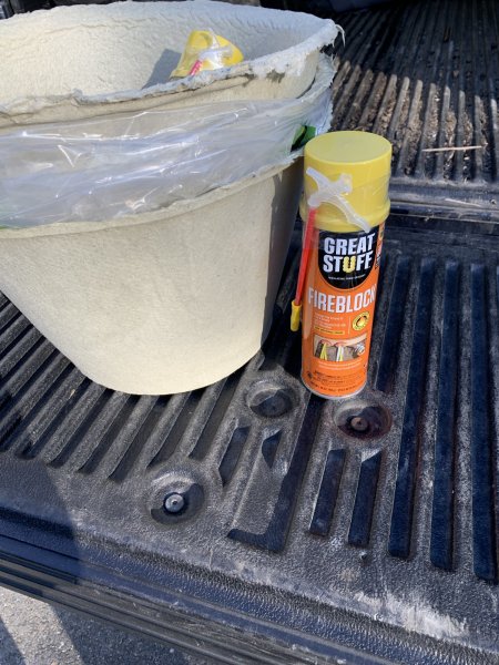

    So, I’m not sure that it would be possible to do soffit vents in the front of the house as there is a knee wall the length of the front on the inside and a 3rd of that outside is a porch. So would only having the soffit vents on the back side of the house only be effective.
    Here’s the start some hats and some foam. 111570F8-1690-4758-8664-FFAC579E21E5.jpeg
    Wife is starting to back pedal on the recessed light. She didn’t think it would turn into a project. I may not have to go up there after all! Lol
