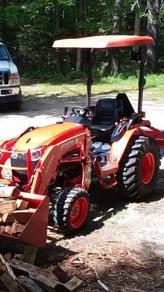

    I threw some led's just under the supports off the ROPS for the canopy that have been a big help, especially for after work snow removal. I've considered switching out the headlights, but they are blocked by the bucket 90% of the time. For the rear, i just have a powerful magnet spot light on the underside of the ROPS just plugged into the 12v power plug. Kinda hard to see in the pic, but these led's are bright!

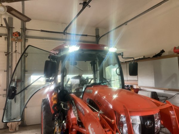

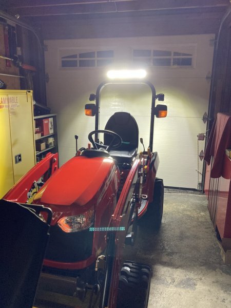

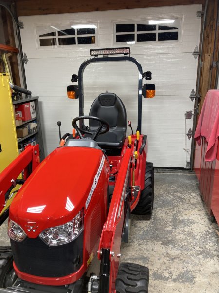

    Finally found a little time to wrap this up Here is what I came up with. Will probably use them mostly for doing snow and just around the yard. They are bright and will be a help with the snow pusher on the front that would block a lot of the light from the regular IMG_1252 (1).jpg IMG_1253.jpg headlights.
    I did end up drilling the ROPS and running the wires inside but that is not a concern for me.

    I did make a small panel and put the switches under the back of the seat, there was an empty spot so I chose to mount them there. Out of the way and won't be used all the time, I just couldn't bring myself to drill into the dash-board. It actually worked out well.
    Thanks for the compliments.
    I did look for over a year (probably closer to two) for a used machine but the prices everyone was asking was insane. When the wife said " Will you just stop looking for someone else's headache and just buy a new one " that's all it took.

    If you ever want to sell it, you could always weld the holes closed, grind it smooth, and spray paint it.
    Looks good, how's the light in front when operating?

    Hopefully good? I haven't tried it yet other than lights off in the garage and it has good light over the top of the bucket from best I can tell. It won't get a ton of use other than doing snow but seems like it should be fine.
    If we don't get snow, I am fine with that but it is probably more of when we get and not if.
    Hope it is like buying a new snowblower and then it doesn't snow.
    Have to wait and see.
    I thought the same thing about welding the holes if I had to, but don't really need anything bigger so if I take care of this one it will outlive me.

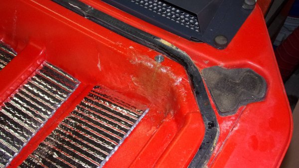

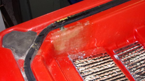

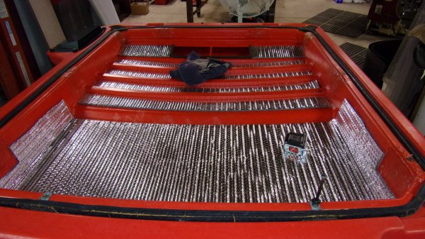

    Depends on the model year how complex or not complex the top panel removal is and what is under it, but never attempt to remove the inner headliner on a Kubota as it won't allow you access to what is under the 'lid'.
    I remove mine yearly and clean out the AC condenser and heater core because all my 'works' are up top, but on later units, Kubota moved the 'works' under the seat pan. Easiest way to tell where the 'works' are is look at where the adjustable vents are located. If you have vents in the control console, the 'works' will be under the seat pan. If the vents are in the headliner only, the 'works' are overhead.

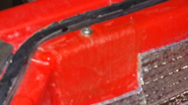

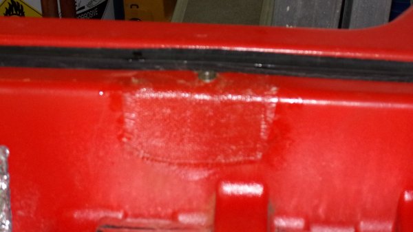

    Like I said, I clean mine yearly by removing the lid. Pretty easy really (does take 2 people as it's cumbersome). I believe there are 8 screws to remove or every other one that go through the inner headliner. You can start anywhere, you just look at the length of the removed screw. Remove the next one and if it's short, replace it and move to he next one. Long secures the lid, short secures only the headliner. One thing I did have to do was, I replaced the Rivnuts in the lid with new ones with backing washers. Kubota sets the Rivnuts without backing washers and they get l0ose and make removal of the securing screws that go through the headline and secure the lid a pure bitch to remove.
    I also insulated the underside of the lid with foil-bubble-foil insulation as the sun beating on the lid with no insulation causes the ac to work very hard and my lid developed some stress cracks which I fibeglassed. A new lid costs 1300 bucks from your dealer.
    I've enclosed some pictures so you can see what I did, as well as the Rivnuts and the fiberglass repair.Also replaced the perimeter gasket (100 bucks dealer) because mine was deteriorated.

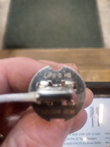

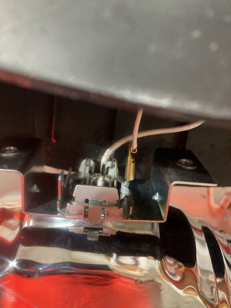

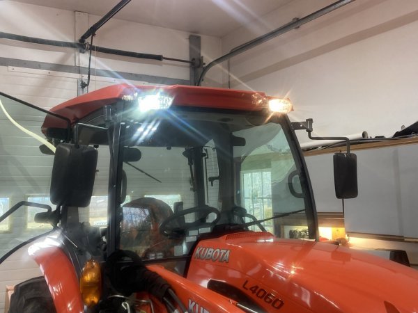

    I replaced the bulbs in the front work lights on the cab. The original bulbs are an H3 so I was able to buy LED bulbs on Amazon. The new LEDs actually use more current so I had to put the front lights on a different circuit (the cigarette lighter), luckily it wasn’t a big job. I’m not confident that those LEDs are gonna last but we will see.
    97F4F915-2933-438C-BD4B-4A1EC3DAB7EE.jpeg 628E1F10-5321-4B51-A7D9-35EF4C3B189A.jpeg C1B08939-DE01-4419-A630-AFF5F09BD941.jpeg BABCCE8F-25C6-4D28-8B61-37C84A144A51.jpeg 0B5A1E0C-72B4-433B-968F-32A2450638A6.jpeg
  20. Chvymn99
    21,643
    115,188
    I'm surprised it draws more current. I thought they drew less current. They look good.
