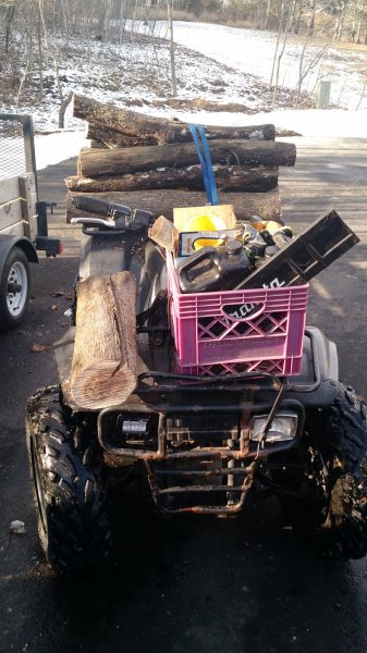

    LED lights are a massive upgrade for headlights on anything over the halogens. I have just 1 of these on my old Kawasaki bayou and it's super bright. No need for any more light in front.
    Amazon.com
    "Amazon.com: Nilight 2PCS 18W 1260lm Spot Driving Fog Light Off Road Led Lights Bar Mounting Bracket for SUV Boat 4" Jeep Lamp,2 years Warranty : Automotive"
    LED pod on the left, original light on the right. That original one is broken glass, but I didn't have the heart to take it out as long as it's making light.
