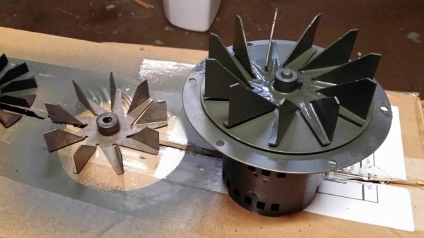

    Here is the bigger impeller (Huge help/11 HUGE blades). The one on the far left that's really small is the stock one for Fahrenheit (13 blade but small blades). The middle one is a Quadrafire impeller (11 blades and a good improvement but smaller than the Don2222 upgrade) that I installed before the larger one on the right. This final impeller has done a world of wonder for my burn.

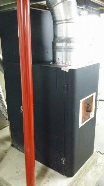

    The only thing that he has I wish I had? Is the extended hopper. In shoulder months? I can go 2-3 days without even looking at it. On cold days (today) I came home and it was running out of pellets (flame was almost out). Where he can still go 2 days.
    His furnace.. And a huge hopper

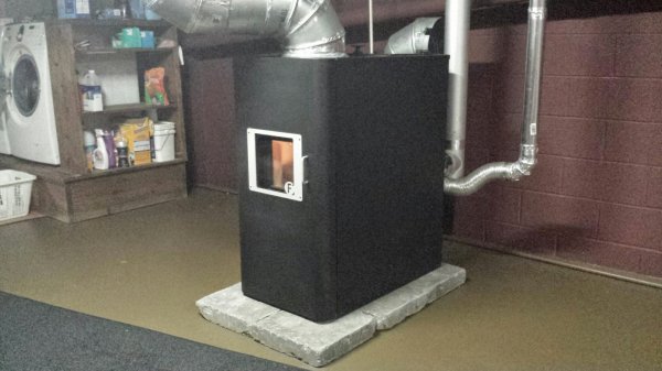

    My furnace.. and a small hopper (117 lbs which is still big by most standards)

    do you know if your efficiency took much of a hit putting that offspec impeller on? Possibly the original was undersized, I have no data on that, but have to assume it was engineered and tested with that impeller. Putting an impeller on with larger fins, at the same RPM, would move more air, possibly putting more heat out of the pipe rather than onto the heat exchanger.
