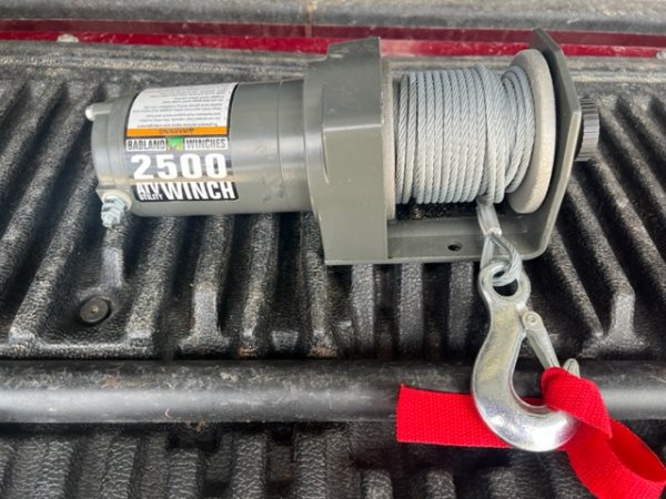

    The only winch I have is this one. I keep meaning to mount it on my SXS, but I'm not sure it will have enough power to pull that tree out, especially once the stump end digs into the ground, and the top end may be wedged in once the bottom moves.

    stihl kicking You may not want to mount that winch to your SXS to pull on that tree. The weight of the tree may do 'not nice things' to your SXS.

    Yeah, a 2500-pound winch will only pull so much and it really depends on the weight of your rig and the mounting point of the winch (I've seen more than one winch fly off a vehicle due to improper mounting).
    I can't really tell how the top of the leaner is hooked on to the other trees but perhaps you could use a throw line to get a strap up high and then using one or more snatch blocks, increase the pulling power of your winch (as opposed to trying to move the dug-in bottom of the tree). You would probably have to tie the SXS off to a tree or you would just pull it to the leaner. Snatch blocks and mechanical advantage can really help in a situation like this.
    If you did try it, listen closely to what your SXS is telling you (creaks, groans) and stop before you do any damage. Also keep an eye on the cable (often the first thing that snaps). Still, if the base of the tree is that rotten, there is a good chance you could snap the top of the tree or the branches that are hung up thereby solving your problem.

    It's amazing how snatch blocks increase pulling power. The top of the tree isn't hung up right now, between the base of the leaner and the first tree against it, the top is just hanging there. Once the base goes, the leaner will drop to the right and the top will drop, and will be wedged. I think my best bet is to get a good yank and a pull on the base, and hopefully keep it going till the top drops to the ground. That would probably be about 15 feet of pull. I don't think the SXS and winch I have is robust enough.
