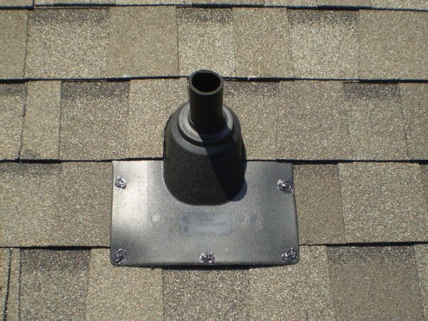

    Here are my attempts at fixing the leaking vents.
    wildwest likes this.

  9. Kimberly
    Kimberly
    Mar 19, 2015
    5,072
    12,819
    The Kangaroo State
    I would try to start early and it would get so hot on the roof that it would burn my hands to try and handle the shingles. So I would have to wait until the shade got on the roof. It took me two days to get that much done. I have two more roof vents to do and another drain vent.
