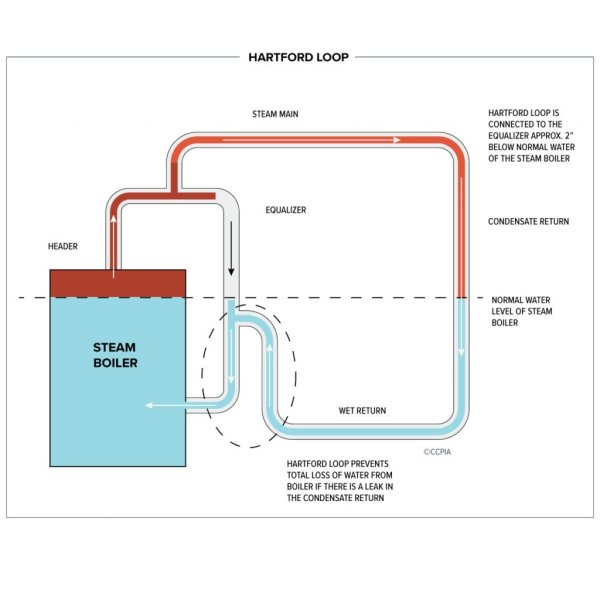

    Ummm yeah, that's a definite no no, mixing pipe types like that.
    My dad used to use that" Hartford Loop" term all the time, he even used to work for "Hartford Steam Boiler Co. ".
    That said, here's a real Hartford Loop
    What we have in the pic the OP posted is just laziness.
    If you want to know more about a Hartford Loop, here's info..
    The Hartford Loop - Certified Commercial Property Inspectors Association
