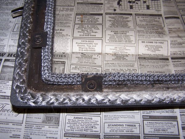

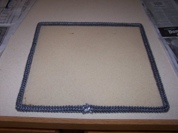

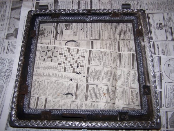

    I agree with BB,,, do it yourself.... The stove guy is going to get it done as fast as he can to go onto his next job.... Suppose he leaves and you now see what you think is still a leak around the glass,,, you'll be diving into yourself anyways... Doing it yourself,,, you'll take your time and do a good job, plus you'll now know how your gasket get's installed.... Maybe you'll even see something outside the book that's causing your leak, bad casting area, etc.. My Esse cook stove just came with a clear high temp plastic looking strip to keep the glass off of the clips and cast iron door... Apparently being shipped to burn coal, they are not too concerned to have an airtight door glass... So after spotting that, I went and got door glass gasket with the sticky backing and folded it around the glass , then slowly tightened the screws holding the clips... 2 turns, wait 30 minutes, 2 turns, then hung the door... Fired the stove,,, on the next reload just touched the screws until snug, not buried... A week later I checked them and all good... Now I have a nice air tight firebox... I'm sure you can fix your own gasket with ease! Listen, you'll be glad you did after you did it...It's not rocket science...
