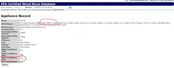

    I can't find where this includes wood stoves. Do you have any links, Lyle?
    I'm thinking "heating devices" does not include wood stoves. Or wood stoves are not considered the "main" heat source.
  9. TurboDiesel
    16,241
    97,581
    I'm wondering if "inserts" fall under a different standard. Kinda like wood furnaces did.
    That chart shows a 1.5 for emission rate.
    Pretty hard to believe they're getting those numbers with a secondary air tube system...

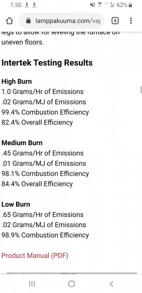

    My Kuuma is 0.09 with no cat...
  11. TurboDiesel
    16,241
    97,581
    Those are great numbers!...Well ...unbelievable actually.
    So i had to go searching.
    Woodstock won the EPA challenge with the IS at 1.04 grams/hr. Kuuma is claiming 1.0 gr/hr on high burn. Excellent results indeed.
    Kuuma is a gasifier?

    Yeah, they call it an updraft gasifier...but still has secondary air tubes...its a little different setup...

    Yes, 100% is a furnace...which makes it even more impressive that they hit the emissions limits without using a cat, because the larger the firebox, the harder it is to make them burn clean!
    And this is not a new design...same one they have been using for many years...with a few minor tweaks every now and then...according to Lamppa, my 2014 0r 2015 built (I don't recall which) VF100 is fully up to date with a 2020 model, with the exception of one internal part that has been changed from 304 to 310 SS...and I have recently updated on mine, just as a precaution.
