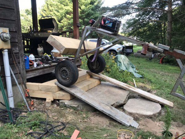

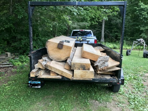

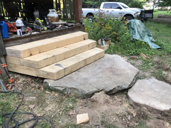

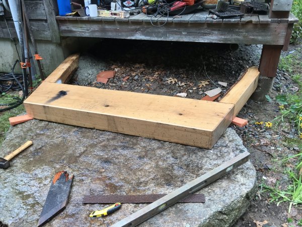

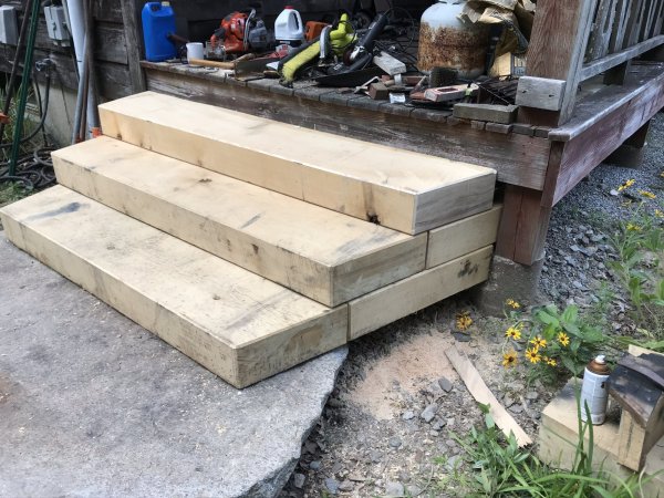

    Had a set of wooden stairs off the backside of the porch. Built out of incense cedar I had sawn years before but never used. An experiment to see how well it lasted outdoors. Needed replacing for several years but never had a good (cheap) idea of what to do with em. Kept junk piled on them so no one would use them but me.

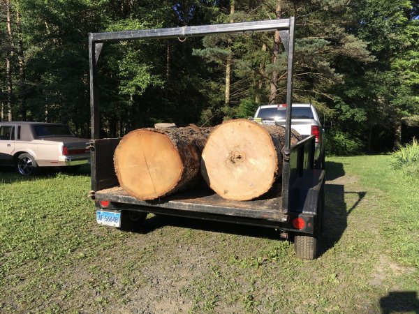

    Enter some big white oak logs that Asplundh knocked down across the street.
    CB628F48-3780-4791-94B7-E787C9FB6519.jpeg FAB473BC-8E43-4C76-ABDE-564C6A6D1DEA.jpeg AC17005C-C6B6-4297-99E1-0942433EB3AA.jpeg E5C10E1B-919E-44A0-9EF7-84C63BAC61F4.jpeg B25A694A-7C9C-47B8-AE36-A0FD67A58470.jpeg
    Was going for live edge but we hit nails on the second cut. Neighbor used stainless to tack up his no trespassing signs long ago. So rough sawn will do. Good I brought the extra log along for emergencies.

    Nice job Joe! :thumbs: Even with the metal stain from the nail they hit milling it!
    Being a tradesperson, im surprised you didnt use brick or block of some sort.

    The stain is from some idiot leaving the 3lb hammer on top of it overnight in the rain LOL Who could that be?
    They’re marked up a bit with rubber from the tires and other assorted blunders. Definitely not being as fastidious about these things as I once was, old age. I’ll call it another experiment if they warp into a pretzel ;)

    There’s already some 8” timber screws and steel angle brackets with 3” timber screws holding it together. Just all blind screwed.
    That being said it’s 6” solid oak slabs. If they want to warp nothings going to stop it. LOL

    Good deal on the blind screwing. I love not being able to see any fasteners.
    I dont think it will warp that much if at all. Oak doesnt seen to warp that much IME. You could always mill some BL for it. I know you have plenty of that! ;) Stuff lasts forever too!

    I considered being lazy and just top screwing them and dowel plug. In reality it’s probably easier to use the brackets underneath.

    Those look great! Couldnt get much more solid. I think its great to use what you got and make it look fantastic.

    Those steps are absolutely gorgeous!

    Those logs are "stupid big"

    Yeah, don’t let anyone tell you green white oak is a lightweight wood LOL. Dang that stuff is heavy. The type of logs that will pick the rear tires of the truck off the ground winching them aboard.
    On the bright side there’s still a nice 3” live edge slab for a bench on the front porch and plenty of firewood leftover. A good portion of the big log is still intact. Got one tread out of it before finding metal. And all the scraps of course. Can’t leave them behind.
    A few decent live edge boards but I told the saw guy not to play around. Paying by the hour and the nails made up my mind to burn the rest.
