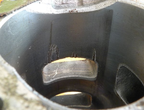

    Well, I procured a good clutch and fanwheel, and got the ignition working again. I thought I might get it running today, and it did kick over a few times on a bit of gas I dropped into the intake, but it wouldn't keep running. Fuel and impulse lines seemed to be in decent shape so I decided to pull the carb and see whether it seemed to need rebuilding. When I took the carb off I could see into the intake, and discovered that the saw had at some point ingested something very hard and sharp, which had bounced around in the intake port and cut several deep gouges into the piston. All the damage had occurred low on the piston and below the intake port on the cylinder, so it didn't affect compression and would probably still run, but I don't want to put it back together like that.
    I'm debating now whether to go with the next-cheapest repair, which would be to soften the edges of the cylinder scratches as much as I can and reuse it with an aftermarket piston for $20. The gouges in the cylinder are small but deep and ragged, though. Decent used top ends are common and seem t0 start at about $85, while new OEM pistons OR whole aftermarket top ends are about $110.
    Considering the fine exterior condition of this saw, it's amazing how many internal problems it has. If I were smart I'd part it out, but that seems such a shame...

  9. NH_Wood
    NH_Wood
    May 11, 2014
    1,265
    4,219
    Ouch. If mine, I don't think I'd try doing much to the cylinder. Perhaps shelve it for a bit and look for a deal on a parted out cylinder on the bay? Or, cut losses and part out - but I can see the lure in getting the old girl running again. Cheers!
