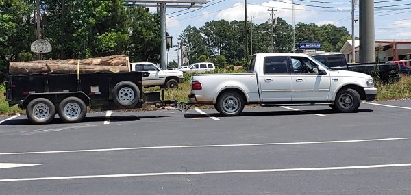

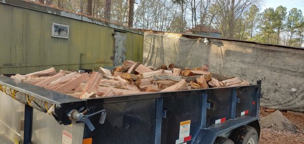

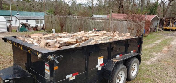

    It all depends on the terrain you are pulling in. Down here we have some hills, haven't had to pull in the mountains yet.
    Make sure you get DA with brakes on both. We pull a 7x12 dump trailer with F150, 4.6L with torque cam. I know I'm overloading sometimes. With the Kubota on the dump trailer, it's about 8500lbs. It will hold 1 cord of wood thrown on, 1.25 stacked level with the sides. We also have 16ft equipment trailer, 16" sides will hold 1 cord stacked.
    I have added air bags and leveling hitch to the dump trailer. IMG_20171213_183511.jpg

    Agree on this. Here in southern indiana we have some steep hills, but they are super short. I like that dump trailer, wish i had one.

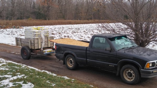

    I have a 1998 dodge 2500 V10 and I overload that often, I even broke off a overload bump stop from to much weight in it.
    That is in the shop right now with the top end pulled apart, so I am driving a 1996 chevy S10 with a 2.2, 5 speed manual and a 1/2 rusted frame... May have pushed that a little as well.
    3500 lbs of concrete not including the trailer or plywood

    Those little 2.2 S-10's were only rated to tow 1500 lbs I believe. Was that a bumper pull? Please tell us no.

    It was a bumper pull, and yes it was way over what is it was rated to pull, I think the receiver hitch on the truck says 1000lbs, but it was loaded so there was no toung weight on the truck and it was only a 7 mile drive, 35 mph with my 4 ways on and all back road.
    I was waiting to rip the hitch off the truck, but I had to get the project done and was in a f$# it mood at said point, if it broke the hitch I was just going to grab the tractor and finish hauling it home.

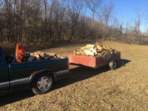

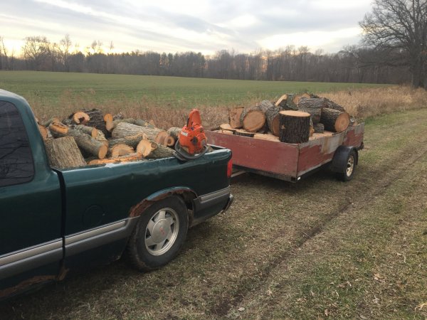

    Alls well that ends well, right? I’ve been beating up my old gmc Sonoma for the seven years I’ve owned it and it’s still going strong. DAB97F46-A54C-4AA1-8E8D-877D6D7AF733.jpeg 19C0E801-5BD4-48F2-BF35-D62CCC91336E.jpeg

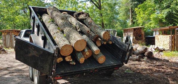

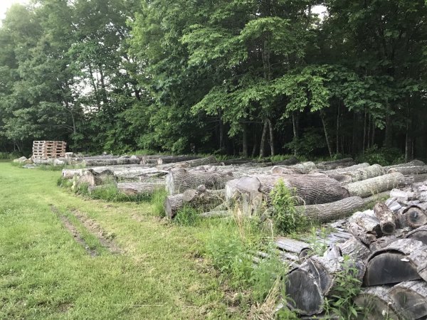

    I’ve been known to overload mine a bit. Can’t imagine living without my dump trailer with winch now. My least favorite part of woodn was always loading the trailer (bad back blues).
    I brought home all those logs the first month I had the setup but that was a once in a lifetime score of 80 oak trees all dropped on the side of the road in one spot waiting for some love. You don’t see that everyday. (little ash in the front)
    For tractor hauling a dump isn’t the best option. Higher to get on and higher center of gravity on the road. 6B1C00B9-ED64-4969-B14C-FE10919B8128.jpeg 8C452CF3-5364-450B-A387-B9783EA23418.jpeg

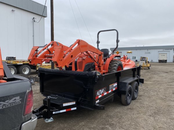

    6A7CD7BF-3672-4DC8-8EC4-DF97B8D8814E.jpeg 8C2BB3F9-A690-46DA-A777-67067E35F682.jpeg Drove 210 miles one way :makeitrain"and back to the house. It towed alright, if I was just buying the tractor and accessories I would have used my equipment hauler and would have had room to spare and not needed to fill the bed.

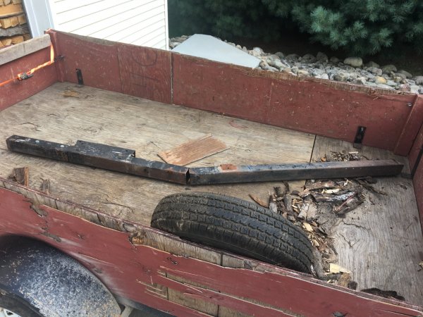

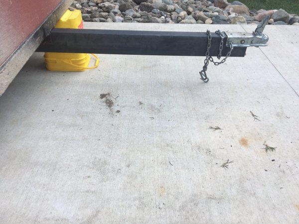

    8D5354D5-C718-4276-87BC-EC50EC9E5076.jpeg FC71D168-5B46-4D81-8403-BDEA6B281F98.jpeg Late august, I was delivering a cord of firewood to a customer. Little further than I usually deliver but didn’t have anything going so I agreed. Just took my time. 2 face in the trailer and one in the truck. Just a few miles from his place, I crossed a bridge and coming off of it I felt something shift and then heard a scraping noise! Slow down to the shoulder and walk back to find that tongue had finally given way and buckled between the trailer and the truck hitch. Shows over! Unhooked and left trailer while I delivered truckload, then returned 2 times to the trailer to get the rest delivered. Took a 2x4 and some ratchet straps to reinforce the trailer tongue so I could pull it home. Went to steel warehouse and grabbed some new steel stock. This one ought to hold! Keep on saying I’m gonna rebuild the sides when I don’t need the trailer for a while. Still waiting for that to happen:rofl: :lol:
