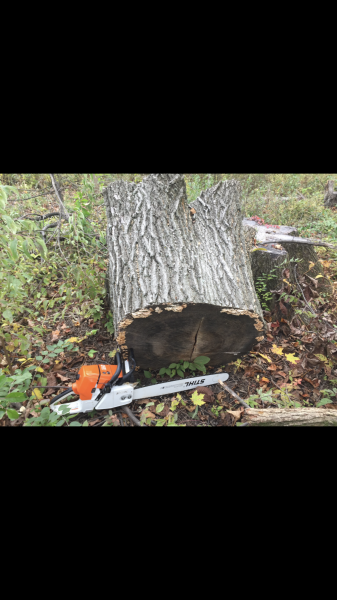

    Here is some of the wood I used to leave behind before I got the 461...that’s a 25” bar when saw was brand new....Red oak..
    Once my dad found out I got a big saw, he had a “job” for me, LOL.....he had the top break out of a maple during a wind storm....
