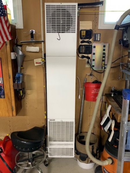

    I just removed a full home sized furnace from this space. It was waaay overkill and took up to much room. I'd like to install a wall mounted propane heater. I'd really like to get a vented model as LP pours the moisture into anyplace you use it without venting. Anybody have a model to recommend? Thanks

    Put this in my garage 3 years ago. It is a Williams thru the wall vented propane, wall mounted. It works awesome, just set the thermostat and forget about it.

    Not sure if they are, (nor can I remember if they are), a sealed combustion unit. Some may be a standing pilot.
    If this is the case, I don't think they would be a good idea for a garage.... May want to make sure about those two features.
