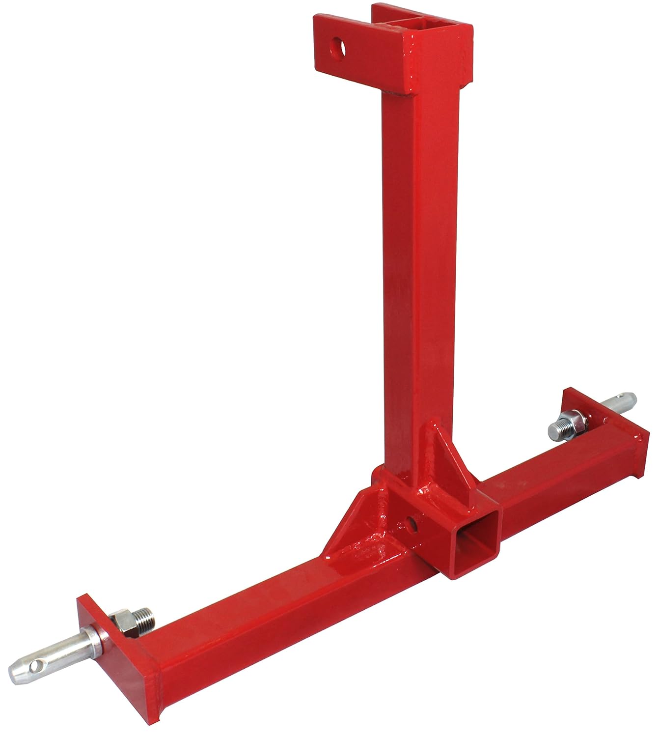

    It looks like fairly young regrowth and you might be able to pick one end of those trees up to hitch it high. Are you "cleaning" them up before dragging them home in a log form?
    One concern is that I don't think that log in their pic was hitched up with the log laying on the ground (picked up first so that the butt plate contacted the end of the log).
    I have used a bunch of cheap skate methods over the years including hooking logs in one way or another to a rear blade, a box blade, and even a $25 drawbar that would lower within 4" or so from the ground getting maximum lift height. That butt plate on your link (in relation to the 3 point pin location) looks like it may "cost" you 6-8" of your lift "stroke".
    or something like this. https://images-na.ssl-images-amazon.com/images/I/71HrYdeC87L._SL1500_.jpg $80.

    The lower the hitch, the less leverage you have to flip the tractor over with. The vertical red line is the primary issue, but the horizontal plays a role, too. This hitch is unnecessarily (and unsafely) high.
    The blue would be better. And not lifting the three pt so high would be even better.

    I have little education in tractor's, hence the questions.
    The drawbar might do the trick for me.
