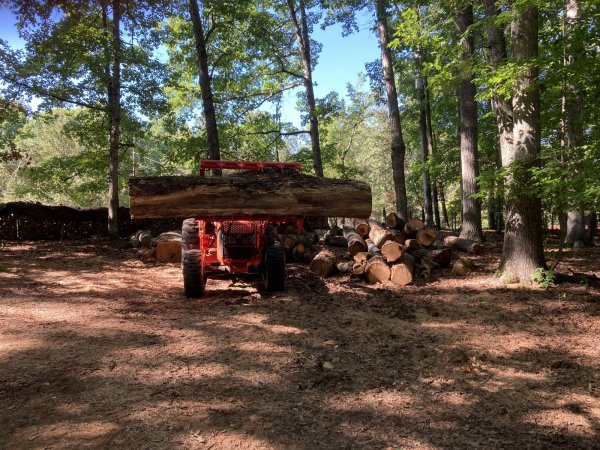

    These don't look that heavy but this was all the loader wanted.

    Those are definitely heavy, that will stack tighter than farwood. Front tires look squatted.

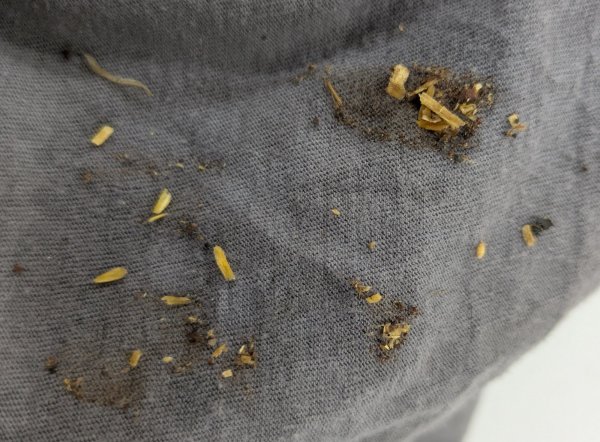

    Went and picked up the tractor and brought it home last night. Did some troubleshooting this morning.
    My tractor has an electric lift pump since the fuel tanks are mounted below the operator station. I pulled the fuel line from the output side of the pump and barely got a trickle.
    After some research on the interwebs I found that the banjo fitting on the inlet side of the fuel/water separator has a tendancy to collect debris and restrict flow. Sure enough, I pulled it off, blew it out, and found a bunch of sawdust. Surely that wasn't my fault. It couldn't be.
    Not sure if they are all like this, but if you are mowing this spring/summer and it feels down on power....might be worth checking out.

    Did cleaning that out fix the problem?

    The lift pump went from delivering 4 oz of fuel in 30 seconds to more than 8 oz in less than 10 seconds. I haven't mowed with it yet, but I'll be shocked if that wasn't it.

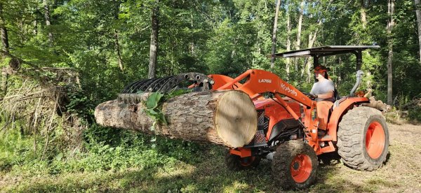

    Big Orange being happy...
    Ripping out a catalpa stump... Messenger_creation_2C53BC4D-0D6D-4EC1-8663-2E799E4A2729.jpeg
    Recovering a nice white oak tree Messenger_creation_44BF2560-BFE4-4D8D-A421-070DEA9EBE7A.jpeg
