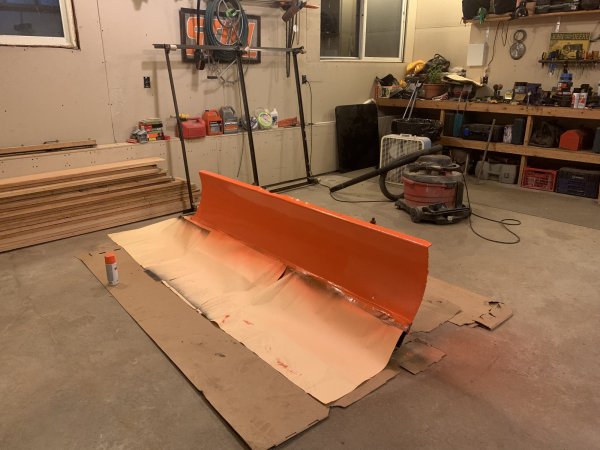

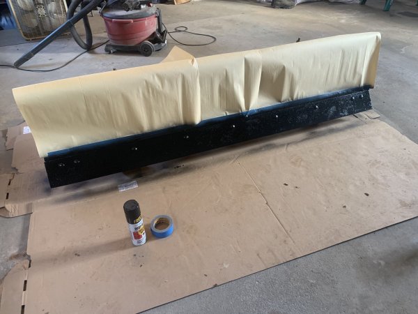

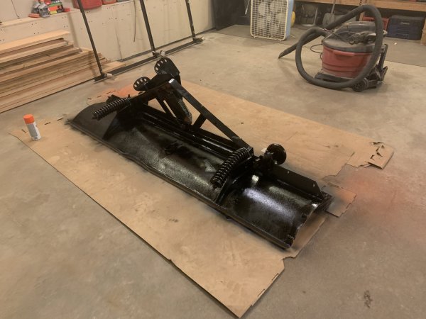

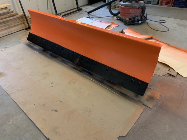

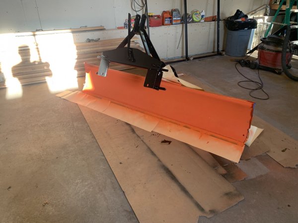

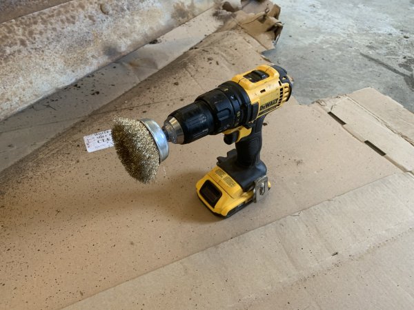

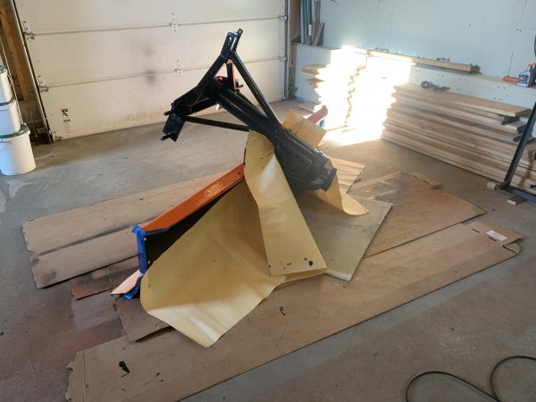

    Amazing what a wire brush in a drill will do with some muscle work. My painting needs some work, but that will come along with experience. The last thing will be a Quick Attach plate mounted to it that should arrive tomorrow or Sunday. I hope. Retired neighbor will weld it on for me. Might have him put an extension on each end as well. We’ll see. Then a little touch up here and there with paint. I missed a few spots. :emb:

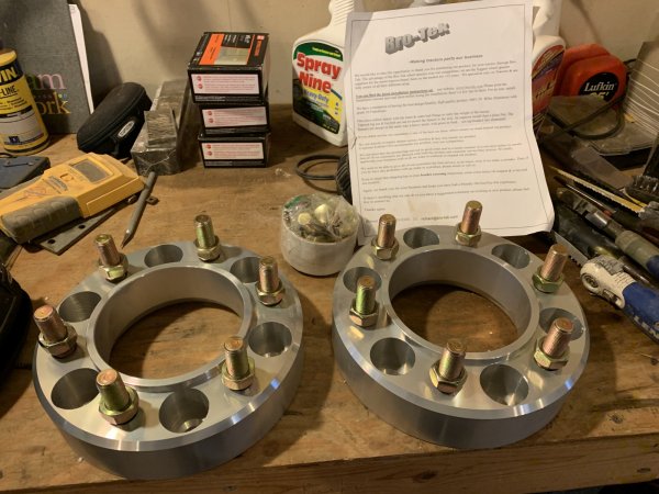

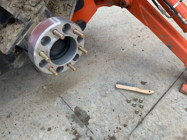

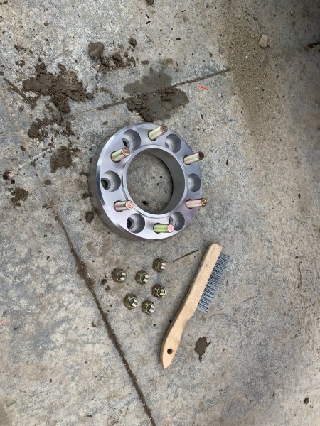

    Wheel spacers, no? For a wider tire/stance?
  10. Gasifier
    20,507
    104,136
    Wheel spacers. Yes. These are two inch rear wheel spacers made by Bro-Tek specifically for the Kubota L39. They make them specific for many models. So the rear wheel on each side will move out 2”. Making room for tire chains. Which are on their way. The Kubota TLB series does not have enough space between the wheel/tires and the backhoe frame. So this solves the problem and also gives the tractor a wider stance. The chains make a HUGE difference in all kinds of conditions. Especially helpful on the industrial R4 tires.

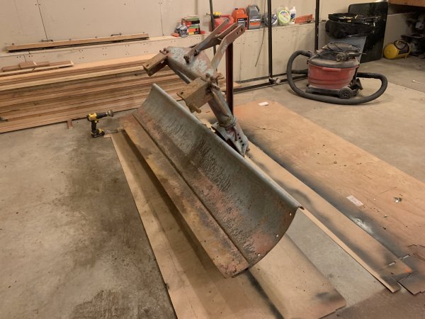

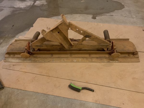

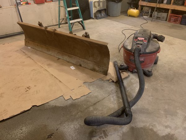

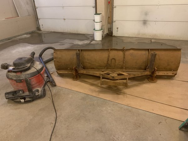

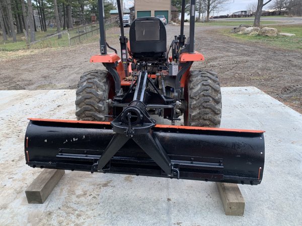

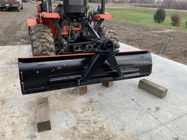

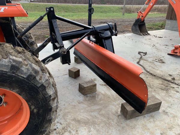

    Good deal on this heavy duty blade. It started out at $600, then went to $500, then went to $300. I grabbed it then. Heavy duty John Deere 7’.

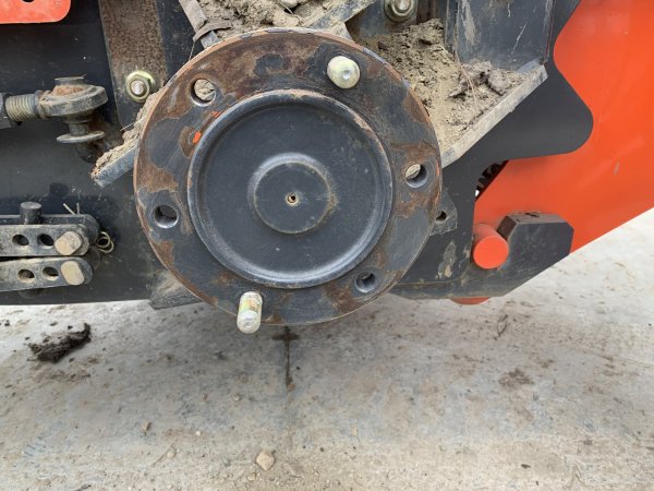

    And these went on today.
    A wider stance and plenty of room for chains now.

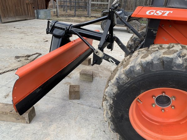

    Not to be "that guy" Gasifier , but you may wanna have the welder fix that ripped out hole for the angle pin too. Blade looks good!
    Chaz and brenndatomu like this.
  16. Gasifier
    20,507
    104,136
    Yes. That will be done when Q.A. plate gets welded on. That came today and he will do the job tomorrow. I’ll be working. Great to have a retired neighbor who knows how to weld and is a machinist!

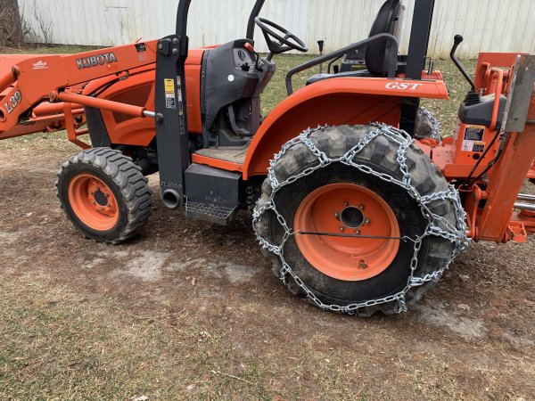

    Now the L39 is ready....
    I may have a little adjusting to do yet.

    Outriggers and a loader, the tire chain installers best 2 friends. :thumbs:
    Good to go Gas.

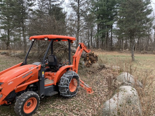

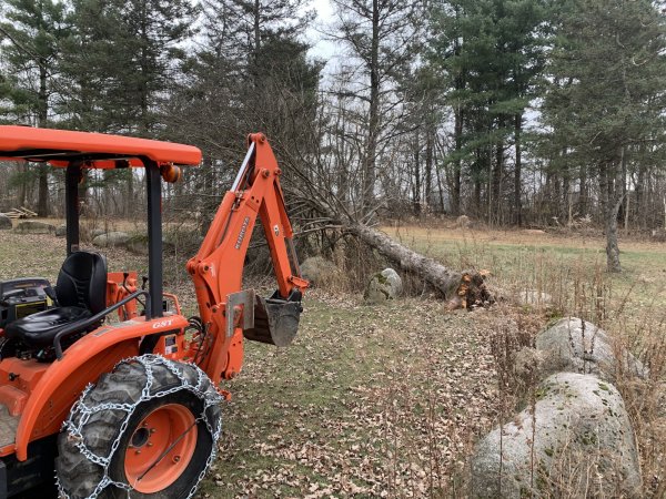

    A little work moving some dirt to a low spot in a section of trail. And pulling this tree up finishing off what the wind storm did.
    3EA770CC-39D1-43D7-9429-F2595D5BFEE8.jpeg 51C3DFC1-A0E1-4B43-9FF8-6B5D5E3A16F0.jpeg
    Once out I had to pull it backing up with it chained to the loader bucket. It was too heavy pulling it up and dragging with the backhoe as the front wheels started coming up.:whistle:
