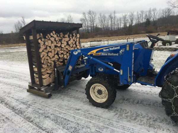

    I have built several designs of movable wood racks. I’ve found that smaller is better, it’s easier on the tractor to move. A square pallet type rack is more stable than a long, single row rack. I’ve knocked over the single row racks when moving them, I’ve never had a pallet rack fall over. Be sure to place “frost” boards under your racks so if you need to move them in the winter they won’t be frozen to the ground.
    This is a nice rack I built but it can tip over easily when moving, ask me how I know!

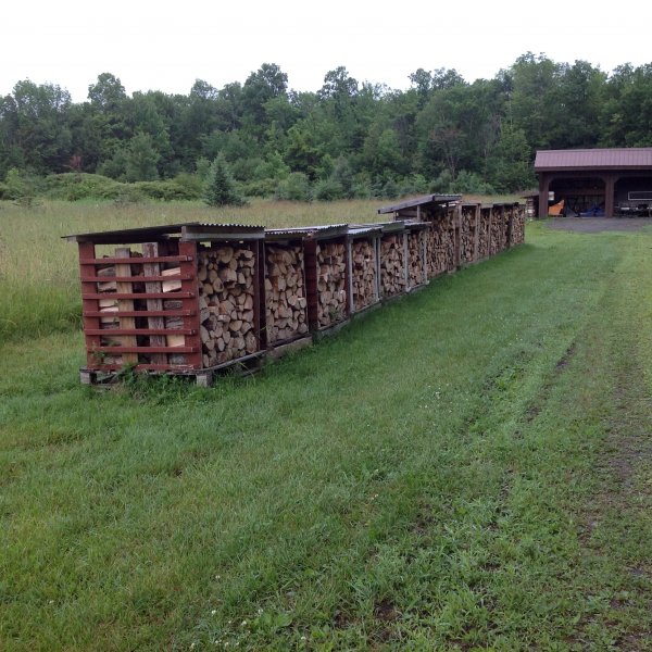

    These are better!

    Thanks you Jack Straw! That’s exactly what I’m looking to do. I definitely like the 4x4 pallets better. You have a nice cover over them too.

    What are the cubes? About 3x3x3ish?

    I think they are closer to 42 x 48x 48 (high) whatever a normal pallet is. If I think a rack is too heavy I remove some of the wood.

    I was at the dump one Saturday and someone threw out a bunch of nice steel roofing!

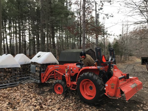

    L3301 here. There's around 1/3 cord in each of these containers. Move okay with the tiller on back. I can move them without anything on the back but don't want to move the far for sure. We took out a little bit of wood (about a wheelbarrow full) and then I could move them just fine with nothing on the rear. (The tires are weighted.)

    Thank you Dennis! That’s exactly what I’m looking to do right there. I’m thinking my L2501 should do about the same since the loaders are the same and I think the capacities are pretty even as well.
    Those are some nice pallets! Where did you find them? Were they very pricey? Looks like they’ll last forever. I’ve seen them around before but don’t remember where. One of the hazards of aging huh? :picard:

    I think the loaders are the same. LA525. Lift capacity is about twice that number.
