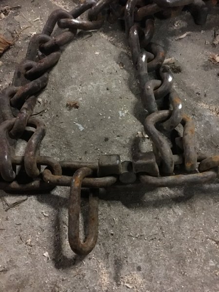

    Here’s one where the side chain is shortened by one link, using one of those “special” links I mentioned. The round plug in the center of that link is rubber. Some of those have fallen out and are lost, but to no detriment. I’ll cut that link off after listening to it clink all last winter.
    Run them as-is, but watch them closely. If they shift, it is sure to be at an inconvenient time and place.

    I have plenty of shackles left, I'll take a better look at it after the storm. There is definitely room to snug it down more.
    Yup, will likely be coming home to a mess tomorrow evening. We'll see what happens, I did leave enough room to slip my hand under the chain suggested by the literature that came with it.

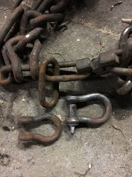

    Thanks for the picture. So the shackles that came with the chains that are leftover should work? The threaded pin head won't bend?

    Here’s a couple of different shackles I’ve used. I check the pins periodically to be sure they stay screwed in. They get worn, and occasionally replaced.
