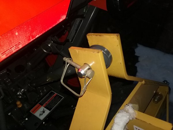

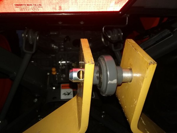

    Will alot of attachment be on the wider end of things at the top link? I picked up a middle buster from tsc since it was on sale and already cheap and had good reviews. Ill need to add some longer pins to my arsenal. I think ill make some good use of it for various things.

    Don’t be afraid to “customize” that hitch to let you use a standard pin. Longer pin is fine but I’d prob block it so that it bends in the right spot and smack/bend it to make a standard pin work.

    I think I'm following you. I basically used a vise to tweek it just alittle to fit the standard pin. But the cotter (?)pin still wouldn't fit so i used a smaller one instead.

    It’s perfect when that standard pin fits with a heavy washer on the retaining clip side to keep the clip/pin from marring the implement.

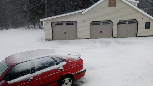

    Don't believe them Well Seasoned, here a pic its coming your way 0216181552.jpg
    Snows not showing but got an inch in last hour
