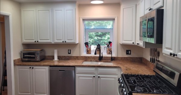

    I finished spraying and re-installing the doors in mid July. This project took four months and was far more labor-intensive than initially expected. But the results are nuts. And yes, a fly did land on the cabinet above and to the left of the sink. Dang things.

    Great job, golf66! :thumbs:
    Nice and clean- bug gives it character :D
