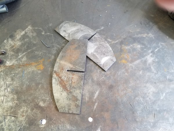

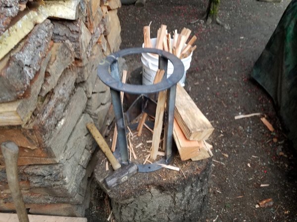

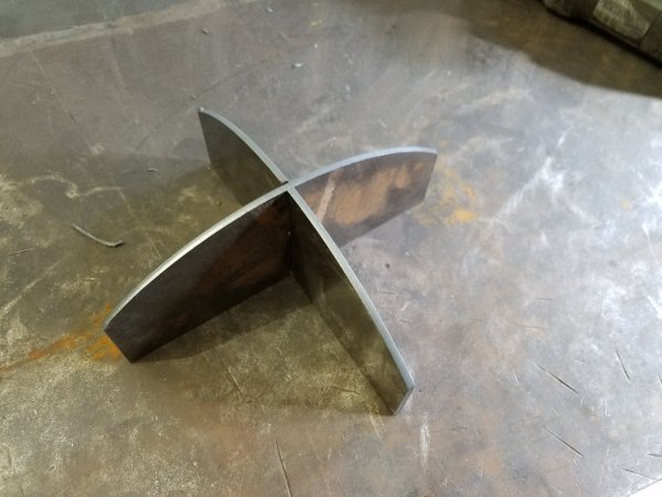

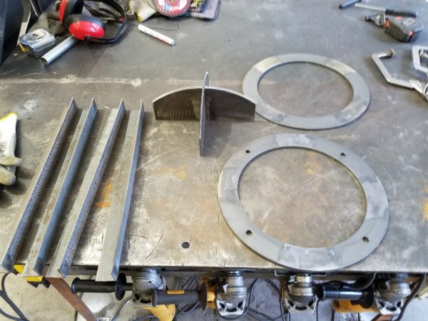

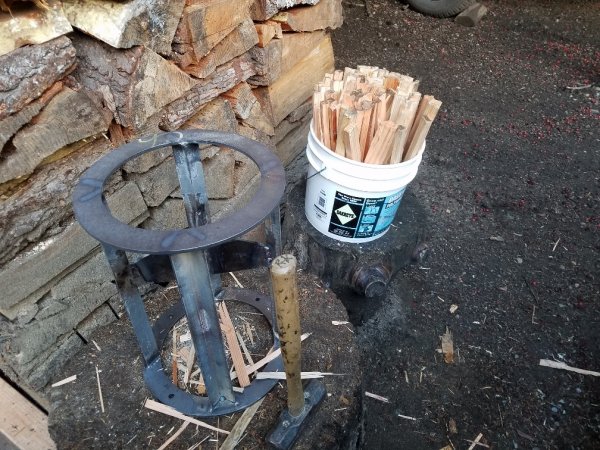

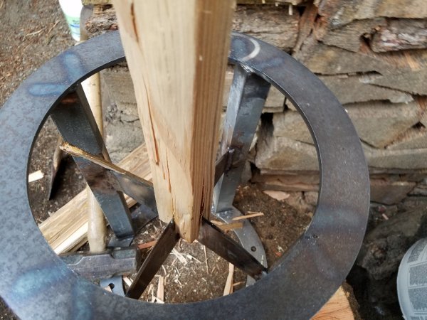

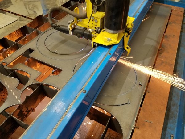

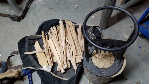

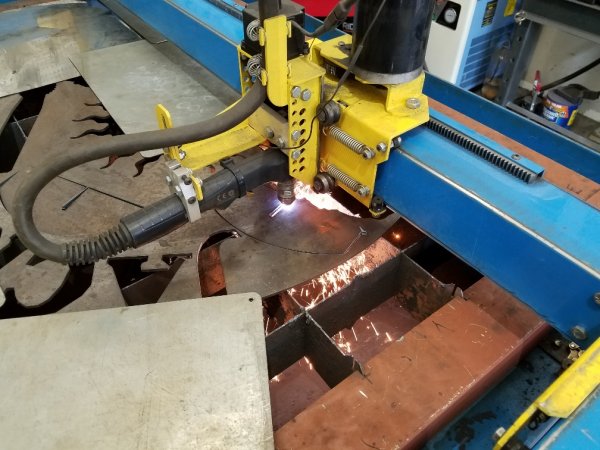

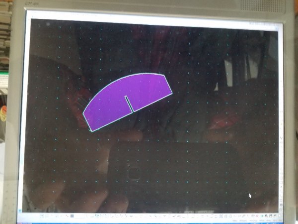

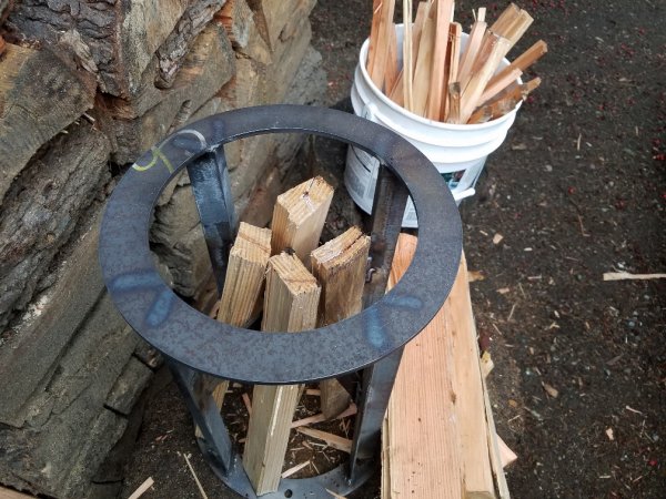

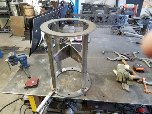

    Just made one today. Blades were cut of 3/16" huge circular saw metal so they are high carbon. Rings are 9"ID and 1.5"wide. Holes are 3/8" for bolt down. Angle iron is 1.25"X1.25"X1/8" thick. Any welding involving the high carbon steel I pre-heated and welded with 308 stainless steel wire. Actually works very well! You first have to split down to about 5"X5" or 6"X6" with the axe, then start splitting into quarters with the cracker. It is a little faster than splitting with a house axe or hatchet but the splits stay contained in the ring instead of scattered all over the ground! Not so much bending down! Fun little project for the afternoon and very functional!

    Did it for fun not profit and it was the first one so a little bit of cut and fit. I have a Chinese acquaintance but I doubt He will be worried! I usually save nice straight grained pieces of fir, especially if it is pitchy, for kindling so no knots. The best part was that the pieces stay more or less contained instead of scattering all around the chopping block!

    So very true! If I do a drawing and cut it out, it's fun to see the finished product. There is satisfaction in cutting it the second time to prove you can reproduce it. Everything after that is just manufacturing!
