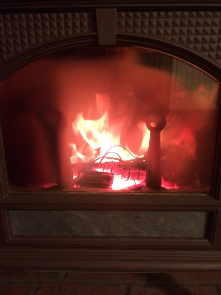

  15. fox9988
    fox9988
    2,710
    8,287
    NW Arkansas 72717
    Maina, Doug, Flamestead and 4 others like this.
