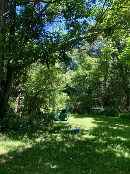

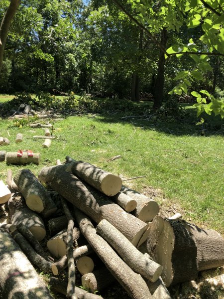

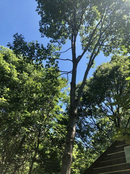

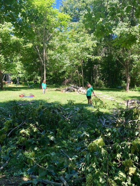

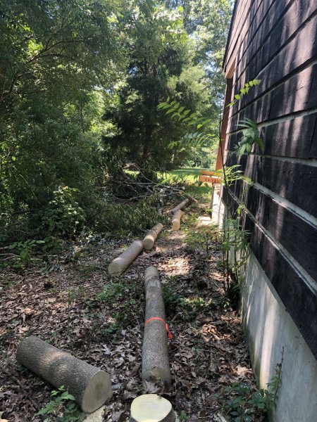

    8FCCA9F0-86E8-41D1-B083-610448248687.jpeg A1064695-0A68-4A8F-A8C9-B490BBDFACF8.jpeg 8C20A5AB-1F73-4351-B584-D40CE6C83A17.jpeg 6453E700-84E0-4E35-BB49-0A5DEB69102B.jpeg [ Lovely July day to cleanup some trees and limbs that were close to the cabin. We cut the branches hanging over the cabin and gave the oaks a nice upright profile. My oldest girls are helping with the brush and are enjoying their new swing too!

    Nice work so far. :thumbs:
    It's definitely good to keep the branches off. Not only does it remove the tree highway for the critters, but will also help keep that new roof job in great shape.
    Seen plenty of moss ruin an otherwise fine roof. :picard:

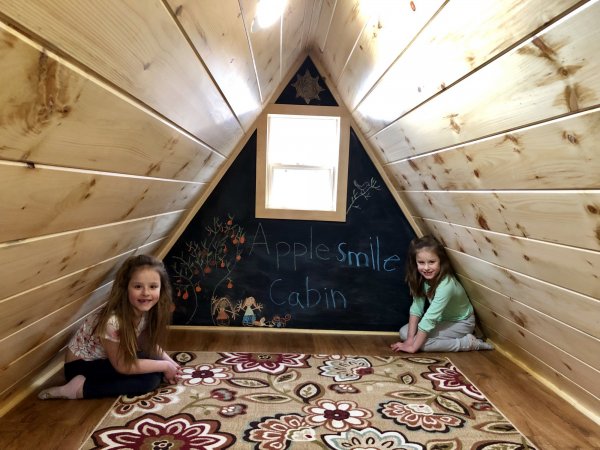

    Still working on the cabin and slowly making progress. We turned the attic storage place into a ladies loft for my three girls. Used 8 inch pine on the walls and vinyl plank on the floors. The kids are loving it.

    Love building threads. You really are doing a fantastic job on your cabin in the woods. Nice family area. Glad you are moving back the tree line around the cabin. Falling trees and limbs are bad and so is air stagnation I don't like the smell of mold or the damage it does. thanks for sharing.

    I really insulated the attic and it originally had side vents where the windows are now. After the insulation I had a serious condensation issue in the attic. We went back and but in a ridge vent and that solved the issue. Live and learn.
