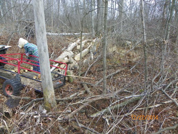

    First we cut it. Sometimes we get into some tangled areas like this. I had to back the trailer downhill and through the brush several times to get this all out. Here, my wife is loading the trailer. She does the small stuff; I do the larger ones.
    Once the trailer is full it gets moved.

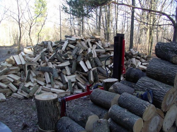

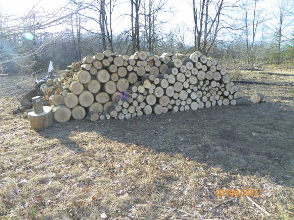

    The wood sort of gets piled up. Usually not very careful in this stacking as it won't stay like this because later it gets split.
    Now comes the splitting. After all the wood is split, it gets stacked right there.

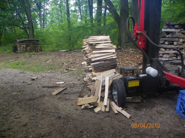

    And usually we make some kindling wood. Some of this got split a bit large but it was beginning to turn into punk so if I tried to split small, it would break apart. But, it made some excellent kindling wood.
