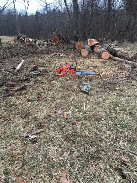

    About a year ago got this 350 on the side of the road under a chair that had sign"Free". I did the steel clamp fix and got it running. This morning I replaced the p/c with nearly new, the boot, division wall and impulse line and took out for the clean up.
    It's lovely with the new 16" bar and chain.
    80% of my time and effort was getting vines out of the field.
    Not quite done making rounds.

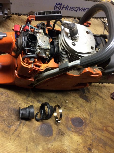

    The steel clamp is to fix a known problem where division wall and boot marry the cylinder inlet port. Older versions had a plastic clip integral to the design that would creep and become a source of air leakage. Learned that here on FHC.
    I replaced the Piston and Cylinder with nearly new.
    All the rest is the plastic and rubber between the carb and the cylinder. They can be source of air infiltration also.
    Let me know if that captures it

    Ok.. so correct me if I'm wrong..
    The boot.. the rubber piece between carb and cyl head intake. Had to replace that on my PP4218 and weedwacker this past year.
    Division wall I'm still a bit lost on.
    Piston/Cylinder I get.
    And it wouldn't run properly because of air leakage after the carb which messed with the fuel/air ratio.

    This is my 353 with a 346xp upgrade, which is only the piston and cylinder. It almost identical to the 350 for our conversation.
    On the bench, from left to right is the boot, the impulse line ( attached to the division wall), the division wall and lastly the steel clamp.
    Ultimately I think the fuel to air ratio is what gets messed up. But I think that's a result of poor impulse to bring the fuel out of the tank.
    The throttle is all about air. The fuel moves by pressure differential created by the piston movement in the cylinder. It's the fuel pump.
    Maina, Well Seasoned and Chaz like this.

    Thx for the clarification.. and Pics to boot. :thumbs::thumbs:
    I guess you could look at the impulse line like a carb accelerator plunger, feeds pretty much raw fuel to the engine under high demand.
    Yep.. that Bernoulli guy was pretty smart.:yes:

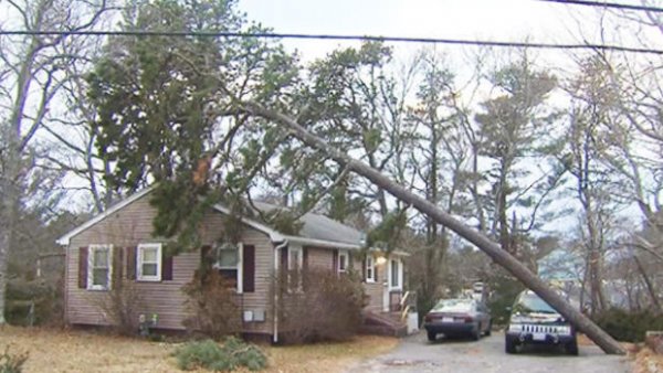

  20. MikeInMa
    15,973
    115,932
    Well now.... how does one tackle this one?
    This blew over in the storm over this past weekend. The Jeep, kept it from falling into the house.
    I'm guessing the answer is vewwwy carefully. And a crane would be helpful, eh?
