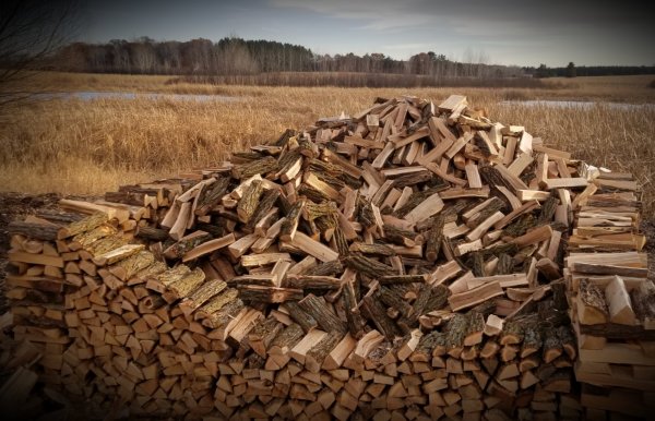

    Stacked on four sides to corral it, tossed in the center. Dries just fine. If your doing 100+ cord a year, thats a lot of time devoted to stacking and then unstacking when it sells.

    mnguns, what wood is that?

    Oak..mostly red, bit of white near this end.

    Your red oak bark looks different from our red oak. I guess it's northern red oak and I have southern red oak.

    That pic looks like a painting
