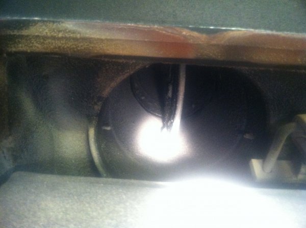

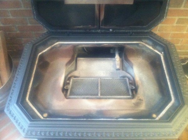

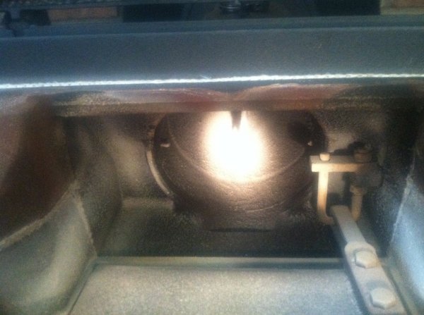

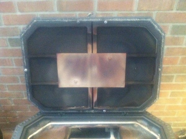

    Decided to take a look inside Garfield's belly after yesterday's fun. :D Here are some pictures.
    Spoke with Mike @ WS about it and he said there was nothing wrong with my load of smaller pieces but that the behavior was typical of an overdraft situation; the sound is from flames burning between the combustor and connection pipe. Only thing to do once it starts is to give the stove a bit more air. He told me of a customer of theirs that had a 40 foot stack that required two key dampers to enable typical operation of the stove. In my case he recommended I run the stove using the key damper until I find a damper position that gives the results I am looking for. He could not provide me any "rules of thumb" - just that taller stacks like mine can experience this overdraft at times.

    Have you got a surface meter on the connector pipe, a probe, or what. How far up from the top of the stove is it? What temps do you generally run on it?
    I tend to ramp my stoves up to temp moderately. I might have the air wide open, but once the load starts catching and flames are reaching the top of the box, I will start cutting the air. I don't want to see big flames sucking hard into the connector pipe. I like to see a lively fire in the box but not a raging one. I don't like to subject the bypass opening area or the pipe to excessive heat.
    Stoves are rear-vented into the fireplace so I can't have a surface meter at the recommended 18" above the stove top; I have to lay the meter on top of the stainless tee snout, about 8" past the end of the flue collar. I will run that meter up to about 500 or 600, then hold it there until I have the probe and stove top temps I need for a light-off.
    Interesting. That was one of my thoughts, as I posted, but I couldn't see how it could happen. I guess the smoke blows past the combustor but then with a hot cat, the smoke ignites on the other side.
    When it started making the blow-torch noise, did you cut the air all the way and the noise persisted? If so, I think the pipe damper will give you the added level of control you need. My SIL's Fireview stack is about 21' with two 30* elbows through the roof trusses at the top. I can tell that closing the pipe damper definitely has an effect...
