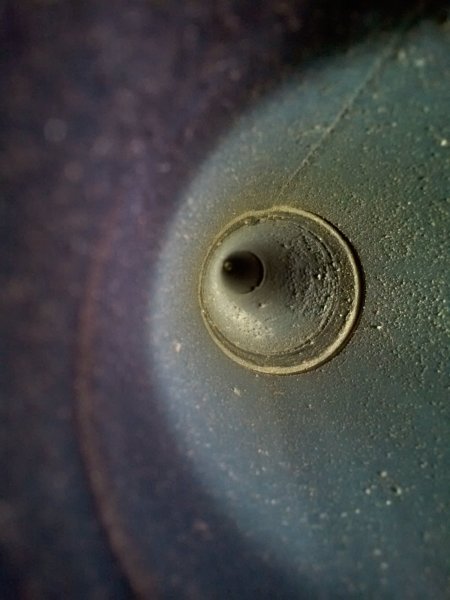

    Here's a shot down the pipe from today.

    There's no creosote there stove is clean .
    I'm no expert but it sounds like a mech break down

    So it could have been the residual build up in the comb blower housing. Why didn't the snap disc open and shut it down?

    I agree these stoves have safety built in to prevent these type of things ,so something F'd up

    I would definitely change the snap disk, they are cheap enough. You could also pull the current one and test it and see what it does.

    Not that i could find. It does say to run the stove on high for 15-20 mins a day if normally run on a lower setting.
    That's really what i'm leaning towards. My mistake for not cleaning it out 100% before install. If the high limit switch senses firebox temp it may still be working since the fire happened in the exhaust chamber. In my manual it says the switch on the exhaust housing is the proof of fire switch. The high limit is mounted to the back of the firebox area. Im going to order a new one anyways.
    Thanks for the suggestions and concerns guys and gals. I thank God that we were home when this happened. Not sure what could've happened if i had not shut the stove down.
