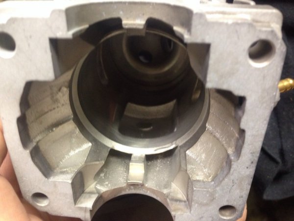

    We'll slap that AM jug on and get some timing #'s.. We could probably steer you in the direction it needs to go...
    And stuff...

    Wow....
    Interesting semi closed, yet mono open ported design of a clamshell there...
    You got my e-mail... Let me know what the ex, transfer, and intake open at with that thing... Who made it?

    Those clamshells can be made to run really well...
    They ain't gonna win a 4 cube race, but properly done, and a good, sharp chain, they'll embarrass the neighbor's pro grade 60cc saw when out cutting wood..
    Everything is relative..

    This is the HyWay cyl. Looks identical to the pics Brad posted of the Baileys "long block" that's available for these too.

    I bet every saw I own that Phil's 290 is a 290 @ 46mm.
    There is more to the muffler mod than what you see. But that's all you get to see. Sorry.
    Why build it as a 290? Why spend money on a 390 when you have free 290 parts laying around? That's why!
    The saw does not have a pop up.
    I cannot confirm nor deny that I touched it with a few different burrs.
    Id be glad to mod your 029/290.
    Send me the muffler, carb and cylinder.

    What's the going rate to "build" a 290 like that? I don't have one, but after seeing that? It looked like it would spit in an 036's face!! :dex:
