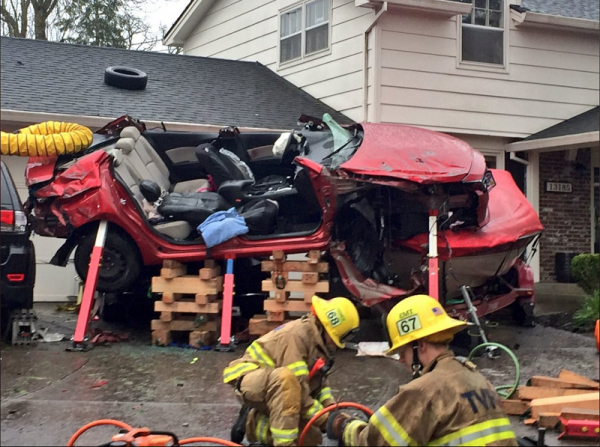

    90144DB5-5095-4553-8B0E-9CFD7335EDD7.png That’s why we only use softwood for cribbing on the fire department. Mostly pine and Douglass fir 4x4’s. Cribbing is wood blocks that we use to stabilize car wrecks, heavy machinery accidents etc. Softwood will crush slightly under extreme pressure, but won’t explode. Hardwood can explode under pressure. Firefighters have been hurt in the past from ruptured hardwood cribbing.
    I didn’t take the picture. It’s just an example of wood cribbing being used.

    I can’t imagine how that car got in that position.... other than a tornado...

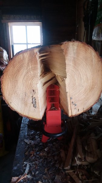

    Just as long as you didn't get hurt. Tools and equipment are replaceable. Your health and well-being are not. I too have had almost explosive splits, mostly with pines or spruces. Even my little 5 ton table top splitter can do some serious damage. The manual for my splitter says not to try and split a round bigger than 10 inches but check this ponderosa round out. It was roughly 20. 20200420_162615.jpg

    That's quite an accident scene... car must have been rockin when it happened. Landed on top of the boat and flipped a tire onto the roof... wow... o_O
