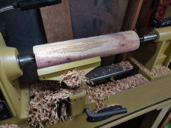

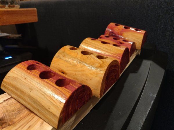

    I'm working a show for a buddy of mine who sells pipes. He didn't have any stands so I said I could probably make some.

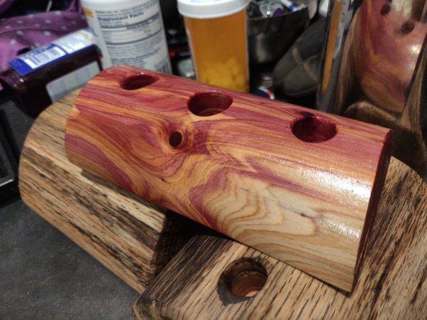

    Originally I tested out the idea on a small limb of firewood that had been perfectly split down the middle, but I didn't like the way the oak looked.

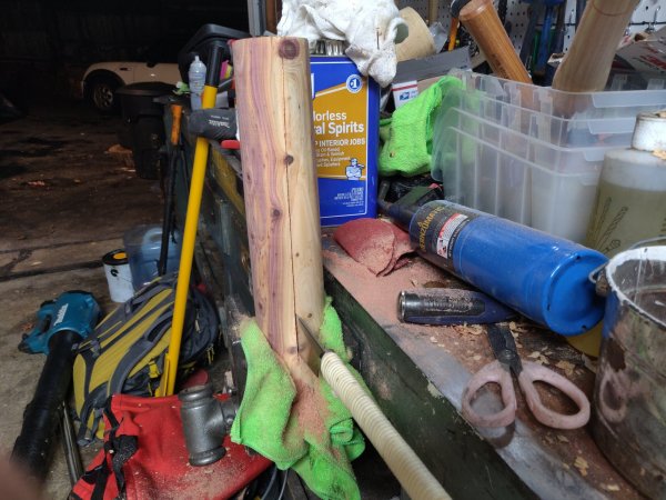

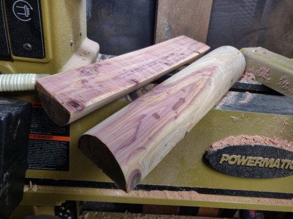

    So instead I grabbed a limb of juniper today, mounted it on the lathe, trimmed into a cylinder, and then it took me about 45 min to rip it in half using a Japanese ripping saw.
    Should have used the drill press to make the holes. Had to go back and make sure the pipes sit plumb and level.
    Sanded with 120, 150, and 220 on the lathe. Used a small piece of 220 to smooth out all the sharp corners. Only measuring I did was to find center.
    Had some small tear out even though I used tape. The smaller forstner bit seemed like it was nicked from the factory but shame on me for not examining it more carefully when first purchased.
    First coat of Tried & True Original Wood Finish is on there. This is their polymerized linseed oil + beeswax. I love the way wood feels with the beeswax.

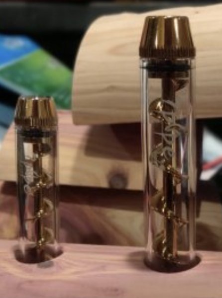

    One could smoke tobacco out of them yes.
    But the point is, my buddy actually designed those. He's the original which is super cool. There are a ton of counterfeits out there. He's legit - designed, manufactured, and sold by him.
