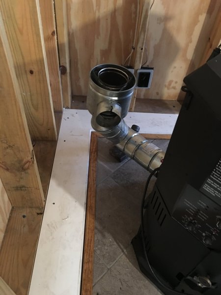

    Hi LW
    What happens when the feeder weld meant tube is worn out? I have not seen that?
    Also guess what stove I am installing in my new shop? They sure made a lot of them in 1999!
