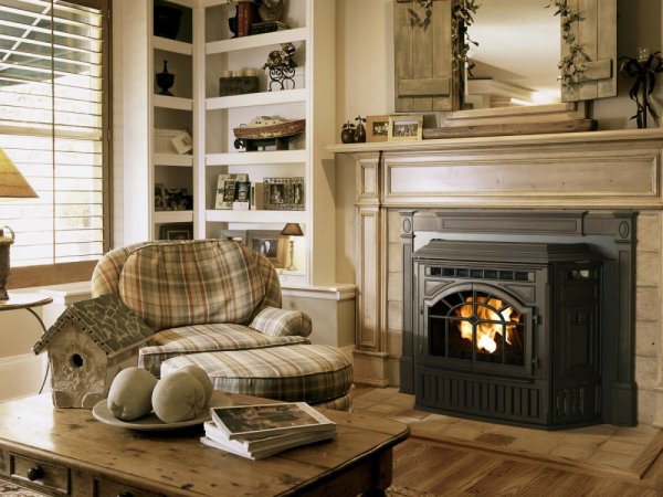

    My first stove was a Quadrafire Classic Bay 1200 (47,500 BTU), and I ran it for about a half of a decade. Great stove and 90% of the time, I kept it on low. Quads are very efficient, and it seems that the E2 is the most efficient model they have made to date. I believe that the E2 uses some of the same technology that the Harman do (varying the blower out to match and maintain temp). If that's the case? Then they hit a home run with that stove. Looks great, heats great, and built to last.

    Ordered the Mt.Vernon E2 insert today!! Scheduled to be installed Aug 18th. Won't the wifey be surprised!:rofl: :lol::rofl: :lol:

  11. savemoney
    That is an impressive looking unit. Hope it is everything you anticipate. Lots of folks here to help you with your questions. :thumbs:

  12. DexterDay
    DexterDay Administrator
    12,411
    31,637
    Northeast Oh
    I think you will be thoroughly impressed.
    One of the best things you can do, and to get the best results from an insert, is to install good block off plates. Both at the stove level and at the top of the chase.
    The next best thing is to install an OAK. Almost every pellet stoves exhaust blower is blowing 80 CFM of air out the house. 80 Cubic Feet a Minute! So instead of throwing the air you already paid to heat, out the flue. Use an OAK and it will allow the heat to get deeper into your home, and stop and cold drafts from air being replaced in your home.
    Selkirk makes a vent set up called DT (Direct Temp). It has the intake and the exhaust all in one package. The OAK air is preheated by the exhaust pipe and helps dry any moisture in the air. Depending on what kind of flue is installed will depend on whether you can run up the existing chase, or if that vent will need to come down.
    Good luck and keep us updated with pics and such :)
