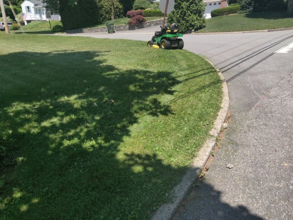

    I really doubt that little bit of damage was the cause for the clumps. I have seen far worse! You were eating quite a bit of grass in that cut. Reducing ground speed, or even better, picking up your cut height would have given a clean pass. Even a 1/2" can make all the difference. WOT is the way.

    In this pic it seems to me I'm barely taking any bite at all. But without getting my face on the turf and taking a pic I do get it's hard to tell.

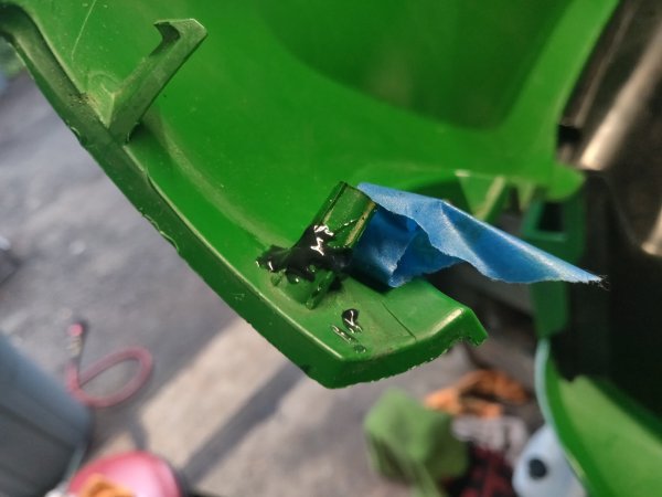

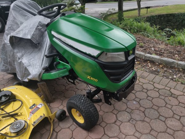

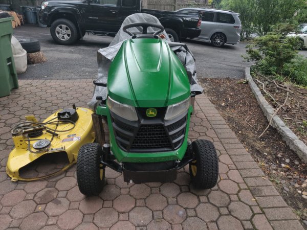

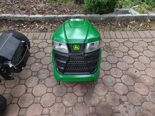

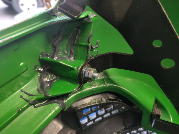

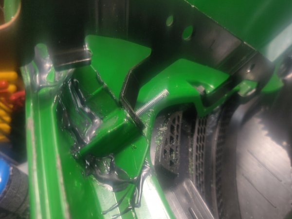

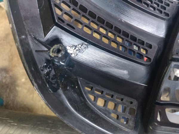

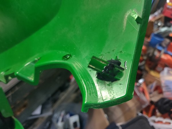

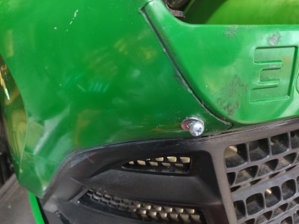

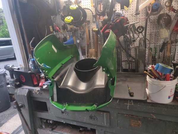

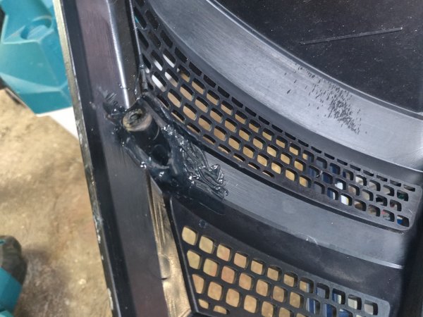

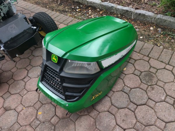

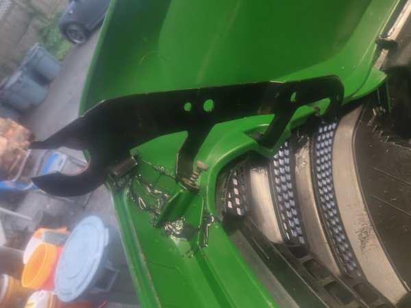

    I also fixed the hood. I used a 50ml tube of DP420NS ($40) and managed to reattach all the broken plugs except for one which did snap. That one had a lot of meat missing on one side so I figured that would be the one to fail. I ended up drilling a hole and using a 8-32 electrical machine screw that was extra long and had to go out and pickup an assorted washer, nut kit.
    It feels nice and tight and unless someone rips open the hood this should last a while. Of course I bent one of the headlight tabs back to straight (OCD me) and it broke so now I have another one on order for $5 at the local dealer. Lesson learned there. That's what I get for wanting that plug to come out straight.

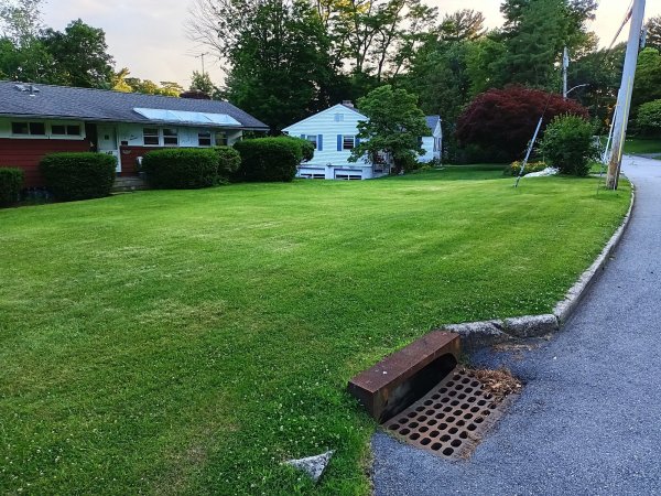

    I drove past the lawn I mowed in the evening after the pool as the sun was setting and wouldn't you know there was the neighbor sitting outside his front door just admiring his lawn. Yeah baby. hahahahahaha. I walked by a little later and snapped a pic.
